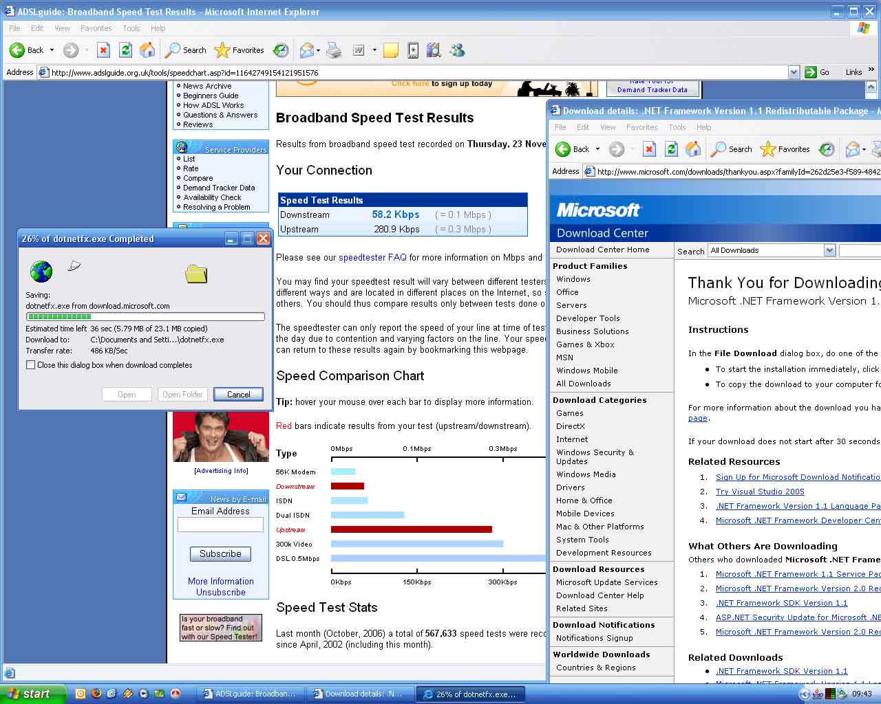

I am trying to attach a file showing a speed test and download at the same time. Hope it works....
58kbps?!?!?!?
As the graph shows that's barely better than dial up modem speed, certainly nowhere near any kind of broadband.
Edit... of course if the Microsoft download is alreay hogging all your bandwidth that won't help, but you still wouldn't expect the speed checker result to be that slow.
Excellent thanks Flat Pack.
