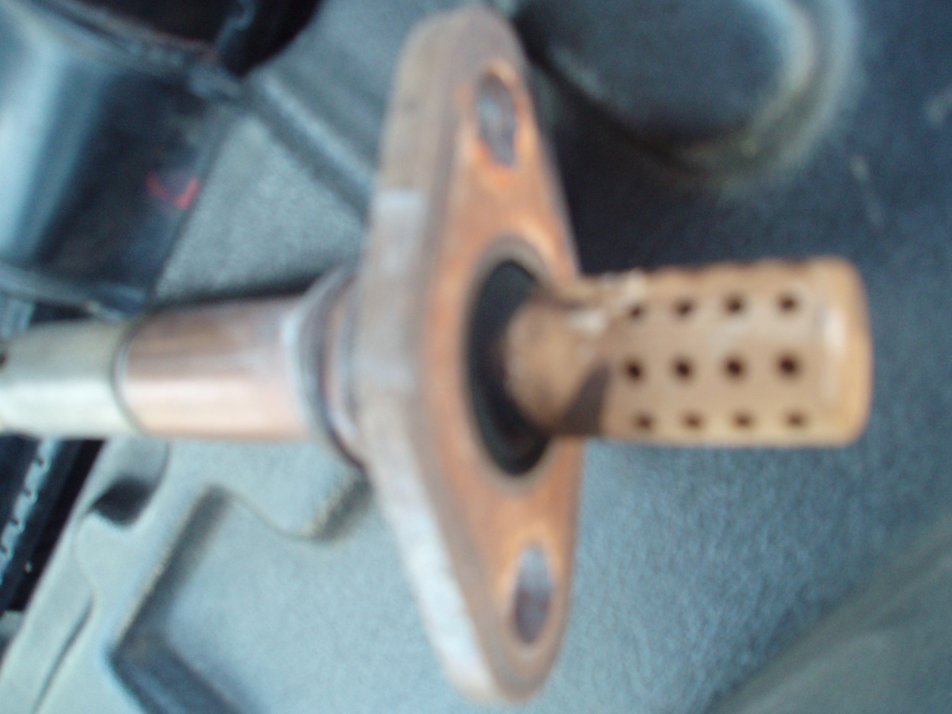

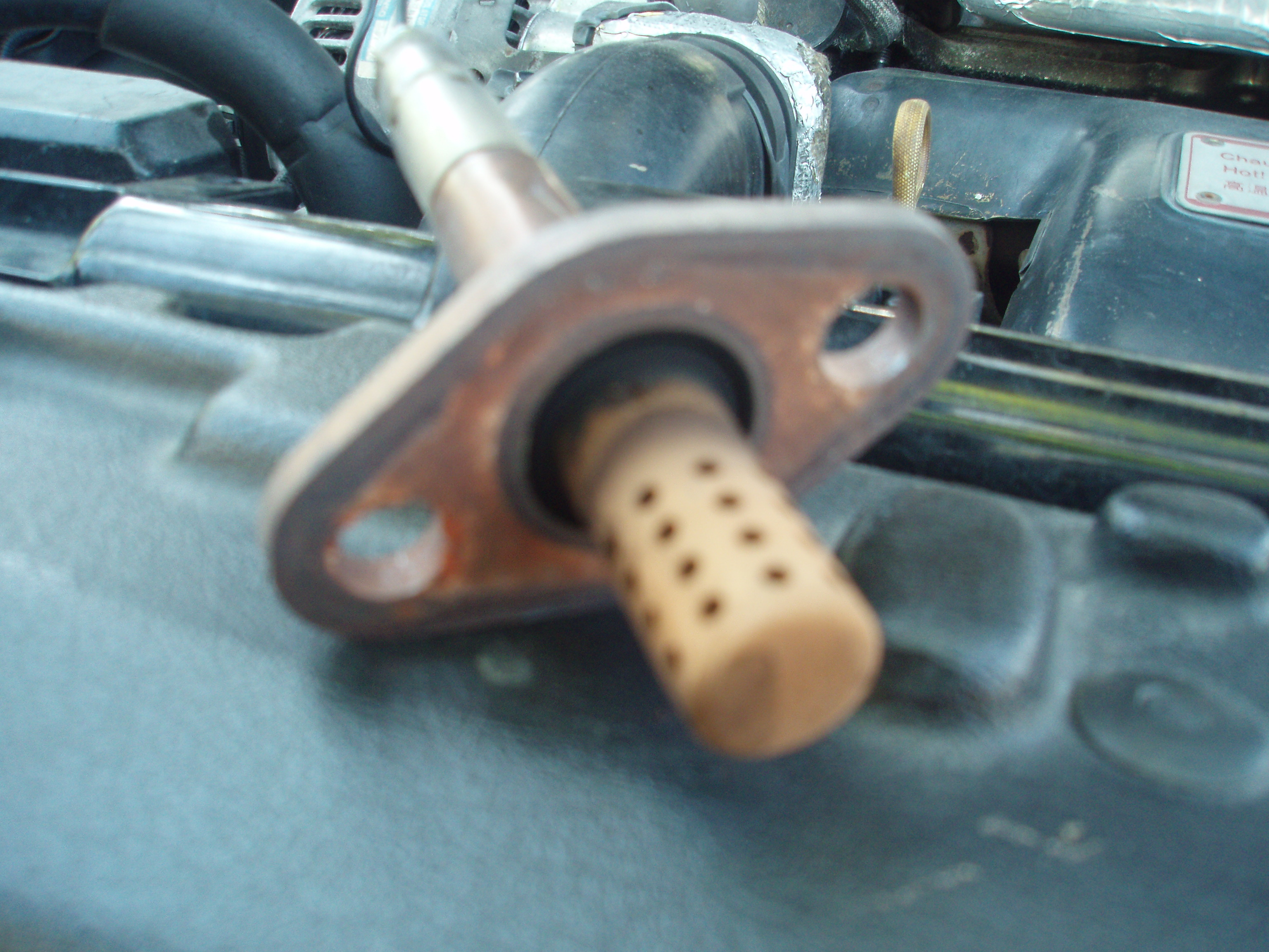

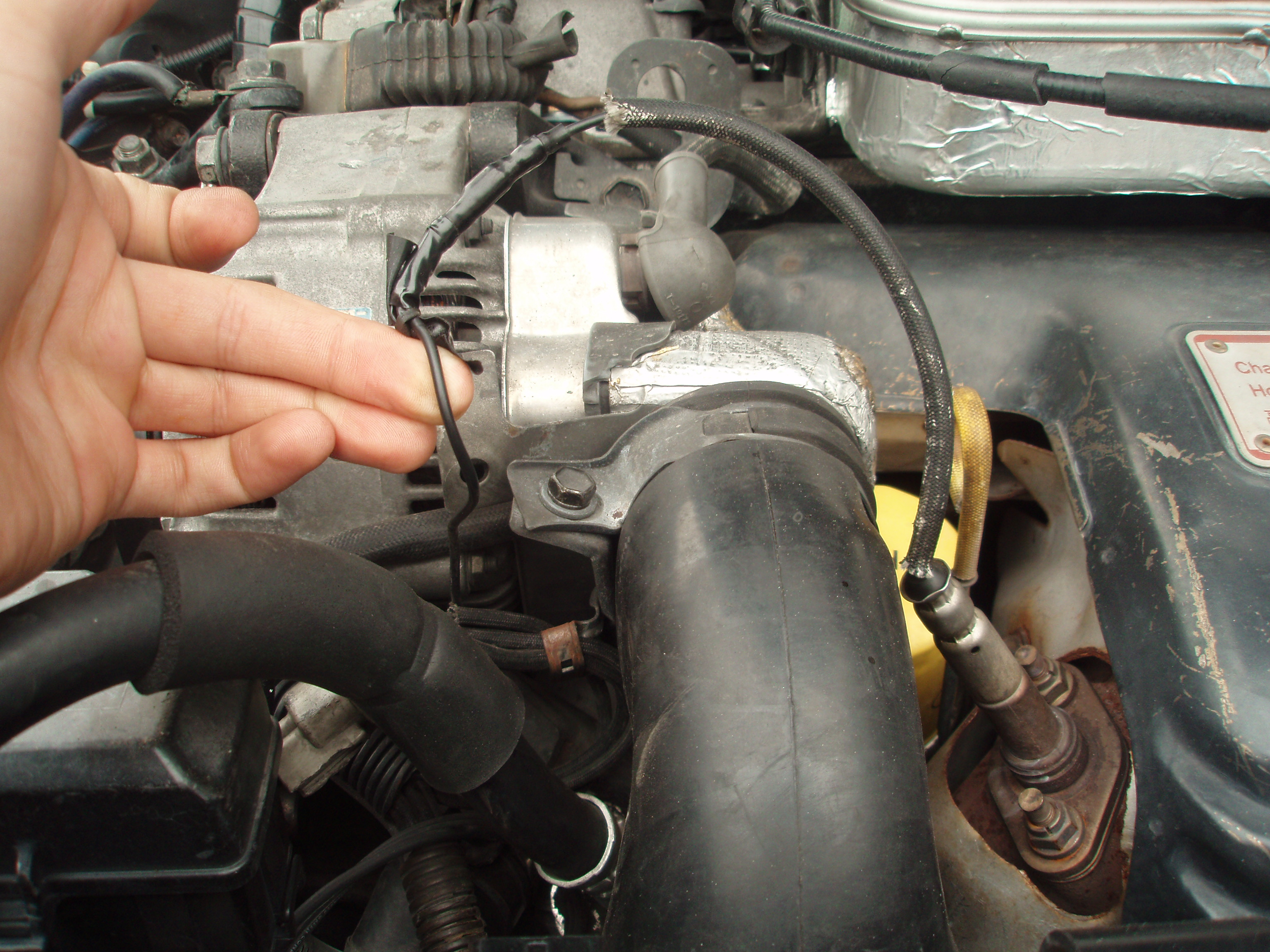

Checked the connection on the O2 sensor, it looks steady as far as I can tell because it has been crimped and shrink wrapped ( don't know why there was electrical tape on top of that ). The tip of the O2 sensor look really rusty and has a bit of black ***** on it but I imagine even a new one wouldn't stay looking pretty too for long in the exhaust like that. Have a look at the pics anyone tell me what you think. Gonna try find a pic on the web to compare.
They look ok to me. I took my Gen 7 lambda sensors out about a month ago and they to were a little rusty but turned out they were working ok(turned out my cat was knackered). you can try giving them a clean with a bit of WD40 and a tooth brush as this will remove some of the corrosion and crap that builds up. That said you can't really see inside them so who knows what condition the internals are in.
