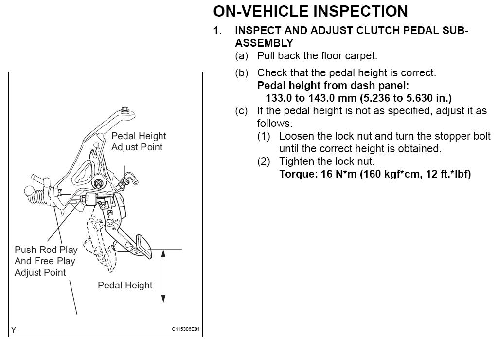

I've managed to aquire the service manual for the new yaris 2007 model (273Mb of pdf files) from which i've created this pic - i'm hoping that it's the same/similar on all other models although i haven't checked yet -but here's the pic anyway... looks simple enough to adjust the height of the clutch pedal... allegedly!
Here's hoping..
Rolf

I know where you're coming from there Brad however, in my particular case the pedal travel is very short from top to floor - just hoping that by simply adjusting the nut (as in the pic) the pedal height can be increased which hopefully will mean more travel thus the bite will be just that bit higher (away from the floor)... just an extra inch would do... hmmmm the wife's always saying that to me!! :crybaby:

ahhh in that case its probably the 'push rod play and free play adjust point' as on the diagram. that has been set too short, either that or some fool adjusted the pedal height too low which should mean once its realeased the pedal should raise up, possibly with the aid of a few good pumps on the pedal, which should lift the biting point up.
good luck and let us know if you fix it as my clutch is a little lower then i would idealy like.

Looks like you hit the nail on the head there Brad... i originally thought just by adjusting the pedal height would be sufficient... it was only when you stated adjusting the pushrod that the penny dropped !! Can't wait to get home now and give the wife that extra inch! :yahoo: Although it's a bit nippy outside..... might leave it 'til weekend.. will deffo post the results...

as toyota fit master cylinder, they have not adjusted it properly, take it back
