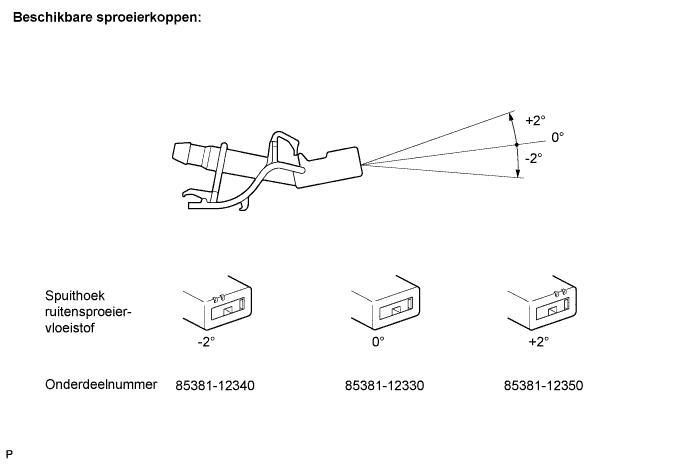

Does any one have a problem with the windscreen washers. Mine squirts water underneath the wipers, so doesn't actually hit the middle of the windscreen. Therefore, wipers actually wiping dry screen when first operated. Also the force of the washer water is such that it takes ages to actually clear the water from the screen. I have looked at altering the direction of the jet, but there does not appear to be any adjustment.

this is what you can do about the windscreen washers there are three types in hight and they are not ajustable :unsure:
