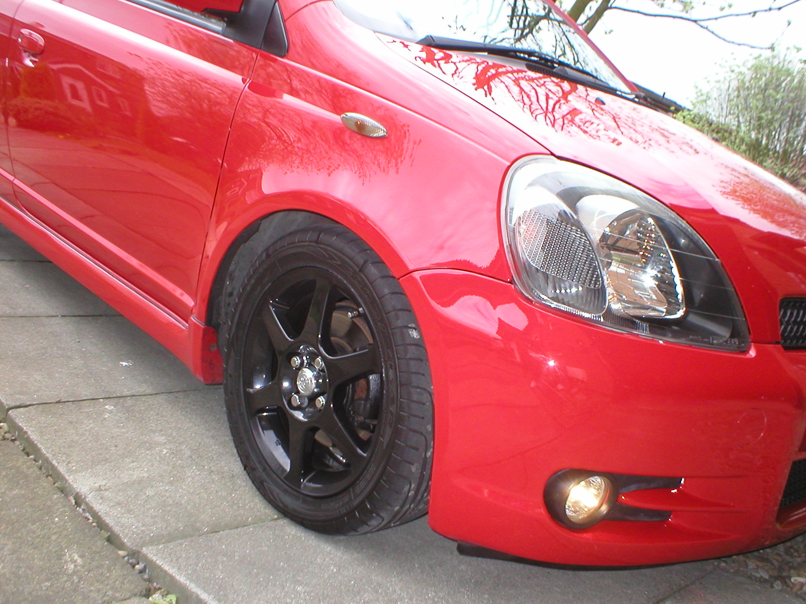

I made my own last summer, looked chav as %$( though.
Bit of a DIY Guide;
1. Remove both wipers, 13mm IIRC
2. Refit drivers wiper arm, on the spindle for the passengers wiper
3. Fit a 19/20" blade
4. Tighten back up
This means the other spindle is on show, but I found that the cap off of hair mousse (I kid you not) sprayed black covers the exposed spindle ;)
