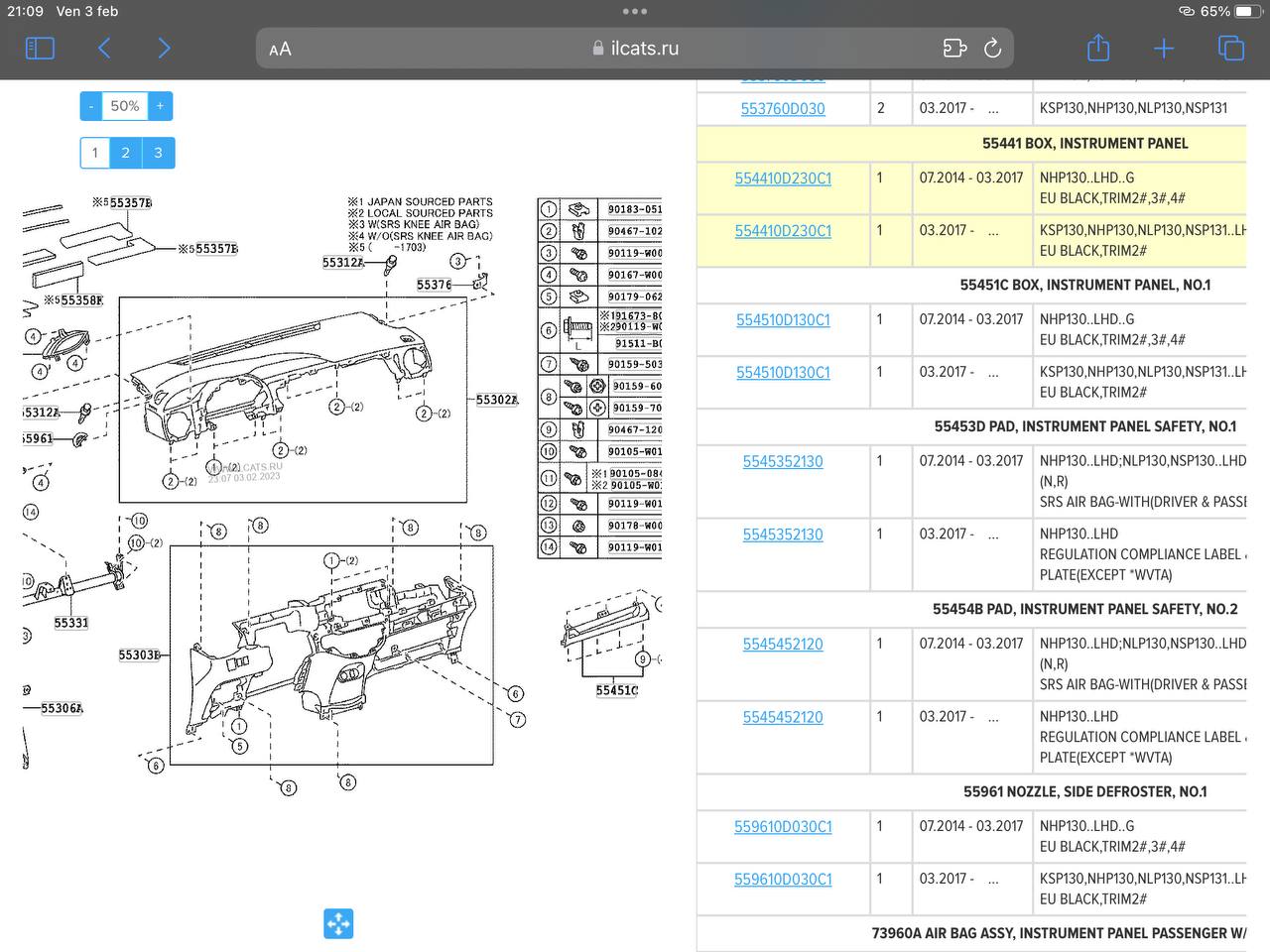

My idea is to apply this product on the external wheel arches (https://www.amazon.it/dp/B07ZQQJ1CD/?coliid=I23D88N1FYR7OR&colid=T4DKPE9DR143&psc=1&ref_=lv_ov_lig_dp_it)
This for the inner door panel (https://www.amazon.it/dp/B071RGKWB5/?coliid=I13R7NEZD0E121&colid=T4DKPE9DR143&psc=1&ref_=lv_ov_lig_dp_it) and also some of this product (https://www.amazon.it/dp/B07TKXCN6F/?coliid=I2WIE936HIVK0A&colid=T4DKPE9DR143&psc=1&ref_=lv_ov_lig_dp_it)
Are the materials good for the insulation job?
For the roof I have no idea which material to buy, because I wanna thermal and noise insulation
for the sealing: I'm using a generic silicone spray (like the yellow cap WD40), but in some plastic joints I put light grease with success (no more crunchy)...my focus now is for the upper front panel (see image), it seems easy to take it apart
IMAGE 2023-02-08 13:20:43.jpg
