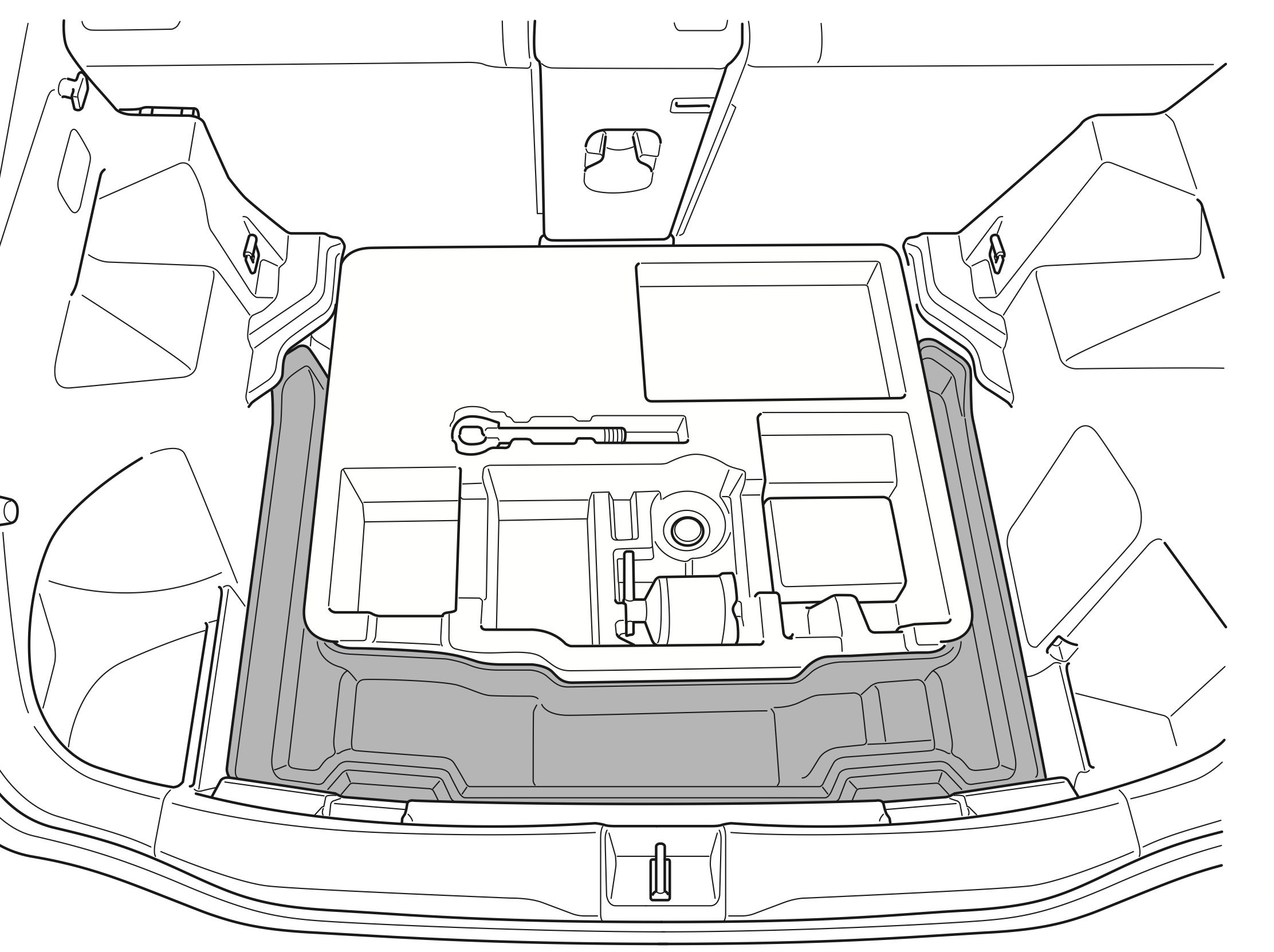

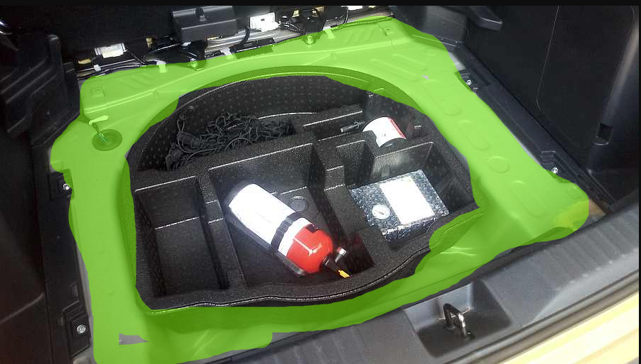

The rear wheel arches and boot are extremely noisy and yaris cross doesn't have a hard plateau that separates the boot from the passenger compartment. If you want to make some deadening, boot Is a good starting point. But you must strip down all the plastic trims in the boot. The double floor is easy to remove, it's only a hard desk and happily, there is 2cm of free space(between bare sheet metal and the second floor) to put some deadening material, I'm going to do that during the oncoming weeks. It will be a noninvasive upgrade. But still, I think it's a waste of time, and no noticeable difference can be achieved because the sound level is subjective.
In the picture, here the green color is free space for at least 2cm of height for sound absorption material.
I am not sure that Toyota cars are noisier than some others because of lack of insulation on the car bodies, perhaps type of insulation, suspension bushes and general set up, door seals and interior cards are more of an issue than some sound deadening materials.
There are already people that has tried adding extra pads along the cabin with minimal or no effect at all. But if you are really interested and want to do it that’s fine, just make sure you are using the correct materials for the application placed at the correct spots and they are weather proof too, condensation forms on the inner side of the car body panels on daily basis., and water goes through the windows seals when it’s raining. 👍
VW taigo, polo or skoda karoq are noticeably quieter. It's a combination of deadening material and a car body design, also suspensions design (road noise) etc.
But these wheel arches and boot deadening may help I think because, from the factory, they are just bare metal with just only a little thin carpet on it.
Mine's not quite like that being AWD but there is the accessory filler available.
