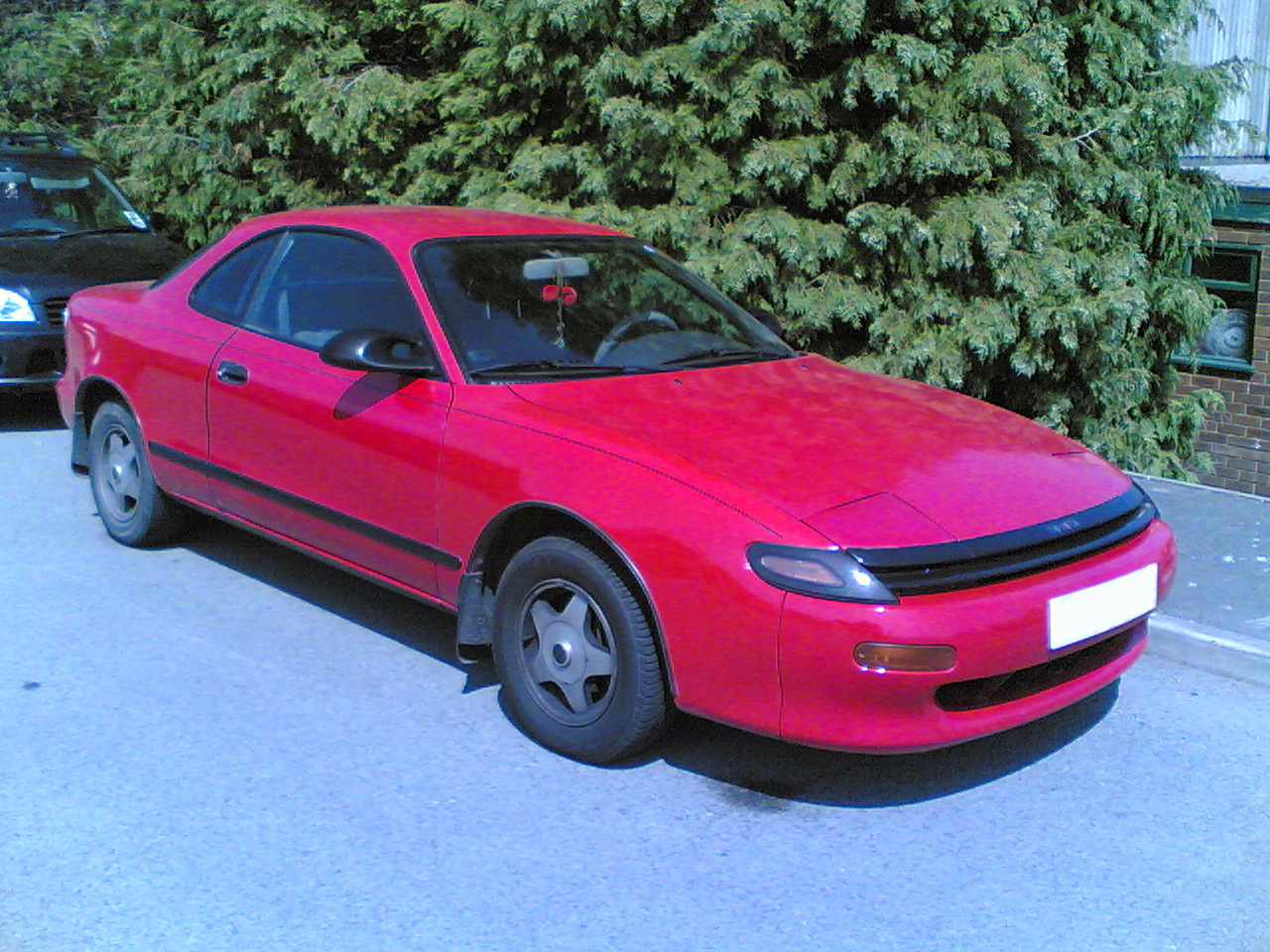

I've got a 1990 Celica ST us spec (brought it over with me) 147000 miles on clock. Started to have blue smoke coming out of exaust when I start in morning. After @ 1 mile it goes ok. Other than that its great. Just had full service. One mechanic sugested it could be the rings on pistons leaking oil & would gost @ £700+++ to fix. Another said replacing engine would be better. Were could I get an engine as its a US spec & UK stoped having ST's in late 80's, would a GT engine do? Any answers/solutions or other sugestions please as ive no idea!!
