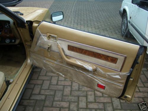

Interior trim is unique to the XT and early models differ from late models.

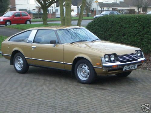

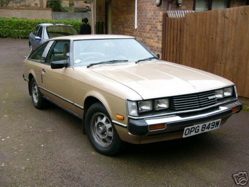

I've three pic of any early XT and a late one, with a pic of the (unique to) XT door trim just for fun.

It's an early round-headlight model ('79) and isn't currently fitted with the original alloys. Going to give the guy a phone early in the week. The rarity is part of the appeal!! Keeping an open mind and I'll be sure to search it for rust and check the basic mechanicals as you'd do with anything of that age!
