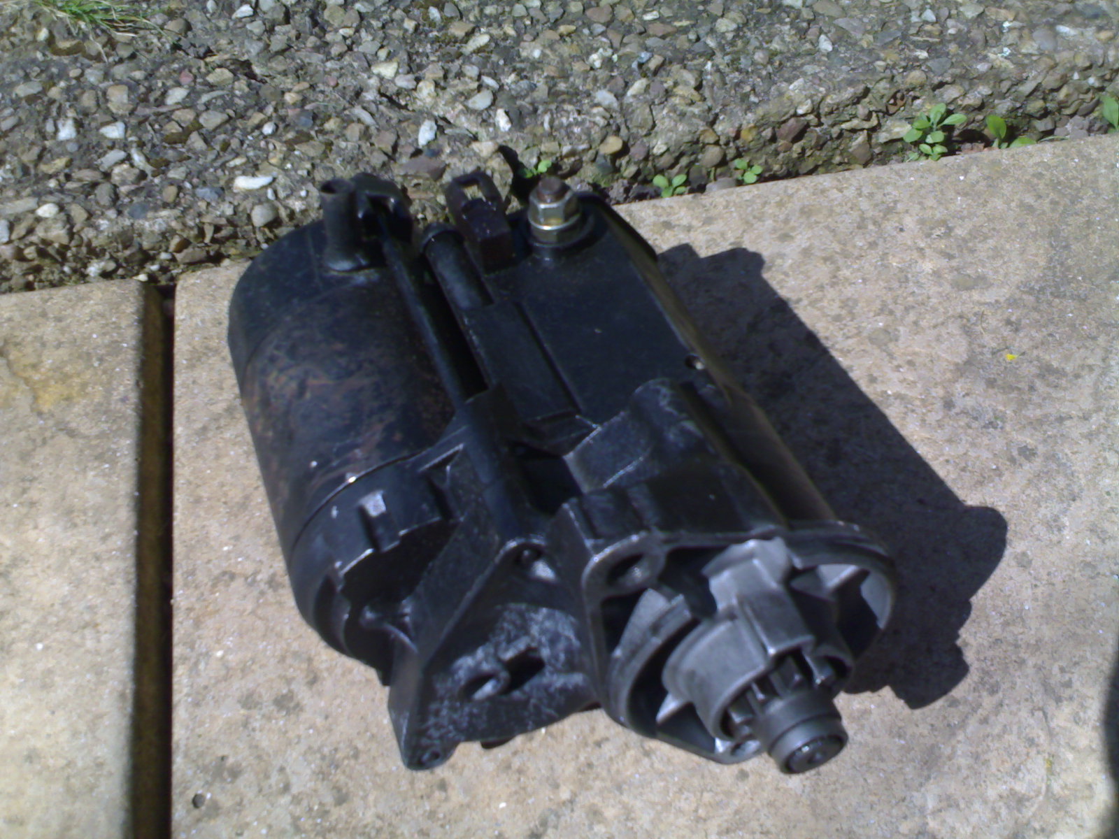

post-33495-1187952009_thumb.jpgHi All,
Can anyone please identify this starter motor it is off the 1990 2.0 petrol auto Hilux Surf i am buying unfortunatly there is no number on it and it has paked up :(
Not being funny, but you have identified it, it's a starter off a 1990 Hilux Surf 2.0 petrol, go and get some starter contacts from Toyota or Milners, Toyota will need your chassis number.
Simple fit the parts and replace.
Get your chassis and model code, I will price the starter and or contact set for you, will be tuesday now as I'm off for the weekend. Kingo :thumbsup:
kit for a 3.0 td is £34 - i presume the 2.0 petrol will be about the same price. pop along to www.hiluxsurf.co.uk its all on there how to do the job.
Thanks all for the help i have stripped the s.motor and contacts are worn down i will go to my local Toyota dealer with the old ones and see how much for replacement contacts go :rolleyes:

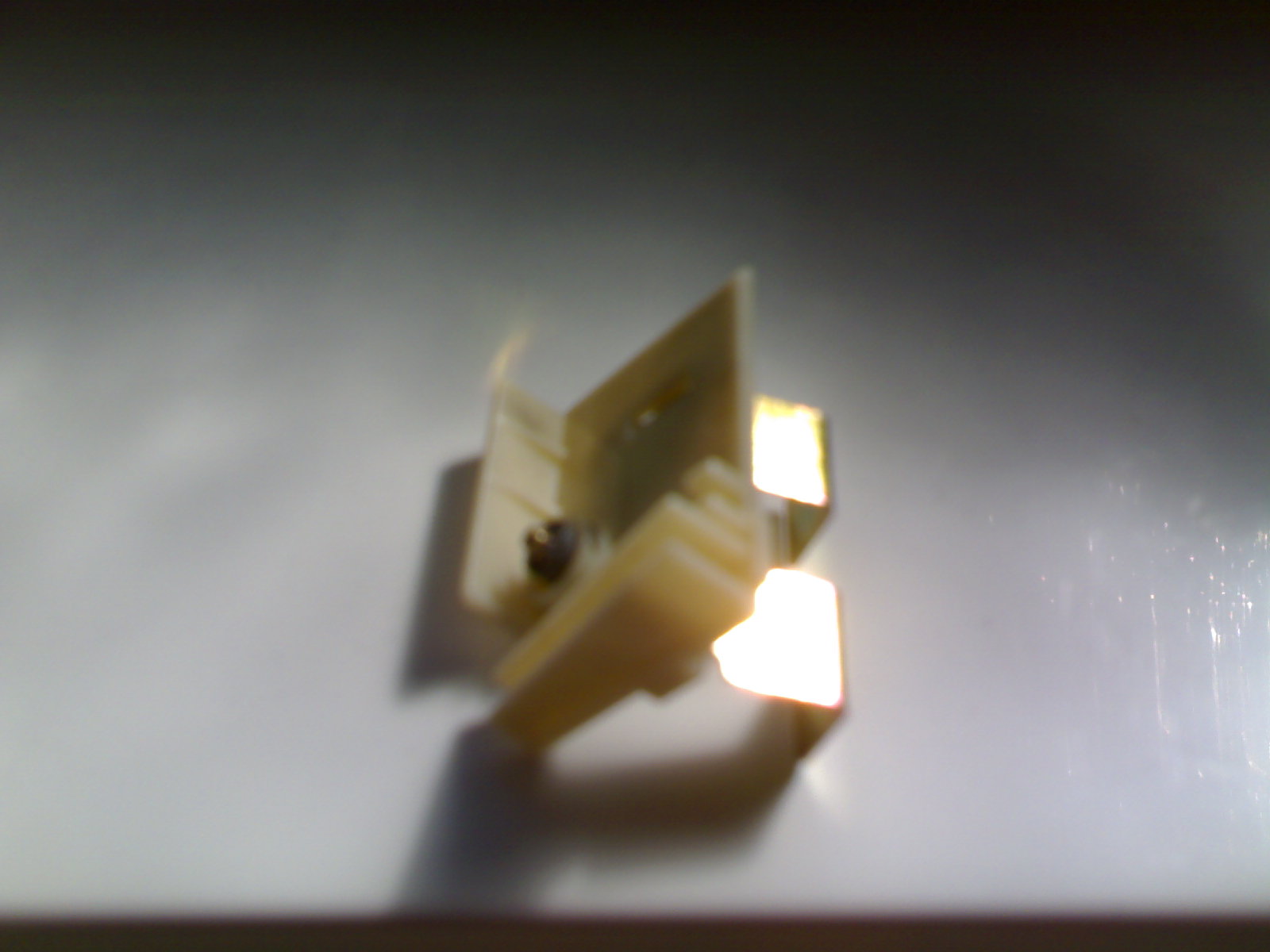

post-33495-1188915270_thumb.jpgHi All,
Thanks for the advice and info very much appreciated i have sorted me s.motor out and finally got my Surf back just stripped and cleaned everything up and away she started on the button :D I will need to rebuild the s.motor at some stage but that can wait for a bit in meantime i have another conundrem for all you knowledgables out there :rolleyes: Ie i opened the sunroof on my Surf today and on closing it i could hear a vibrating noise when i pulled the swith cover off a plastic thingy with two brass prongs fell out can anyone identify this for me pleeeease ;)
P.S Sorry for poor pic quality :(
sorry bud, i aint got a sunroof, i will check the epc though and see if that parts on there , but chances are it wont be.
if yours is a uk model pm the chassis number - that'll be alot easier then .
GT4 BOOSTER you have a P/M ;)
