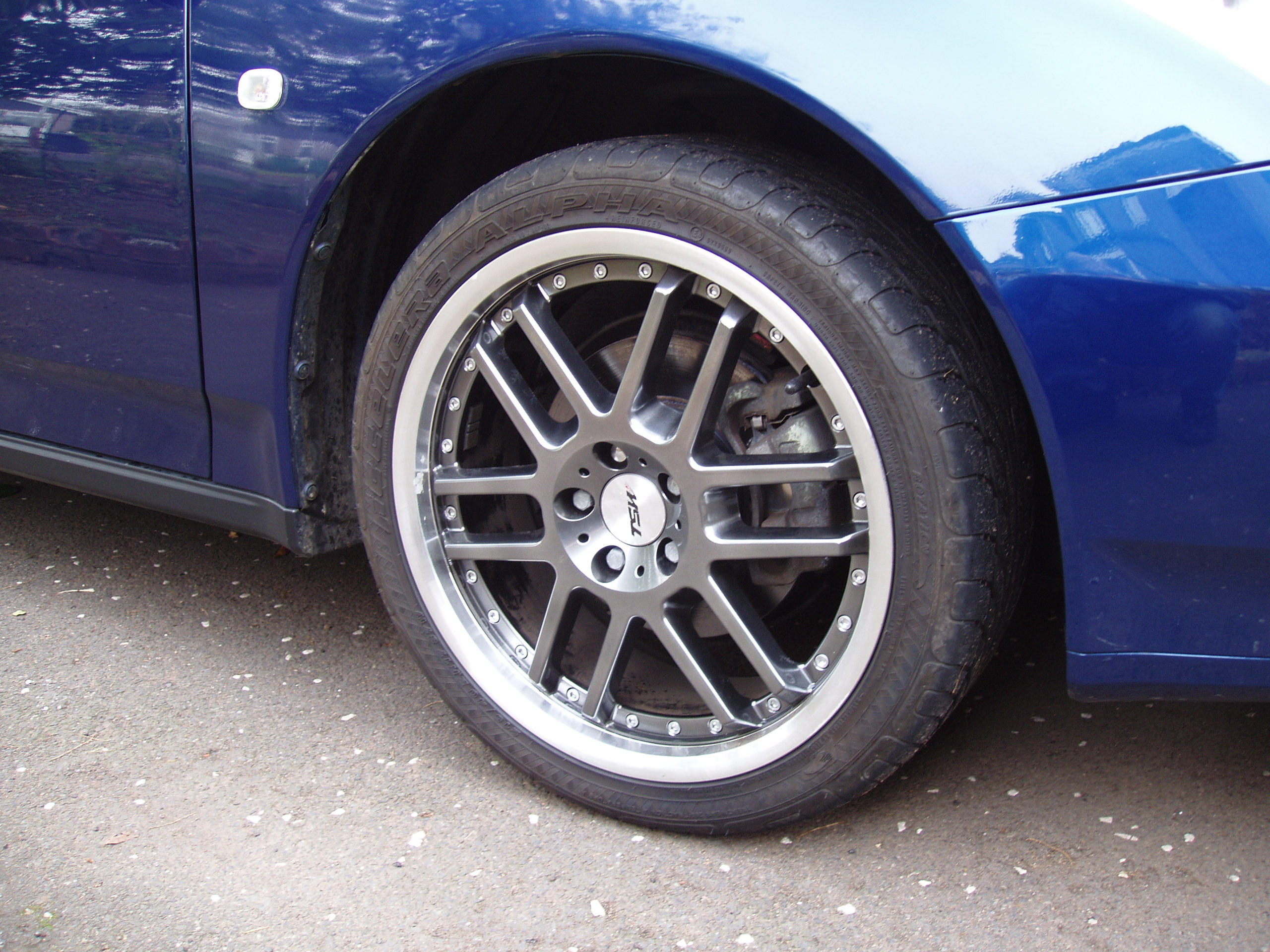

I've gone with 215/45/17s on OZ SuperTurismo GTs. Hopefully I'll be getting these fitted tomorrow, provided the supplier gets them delivered to the place in Birmingham (they were supposed to be delivered today but weren't!).
Will post some piccies when done.
