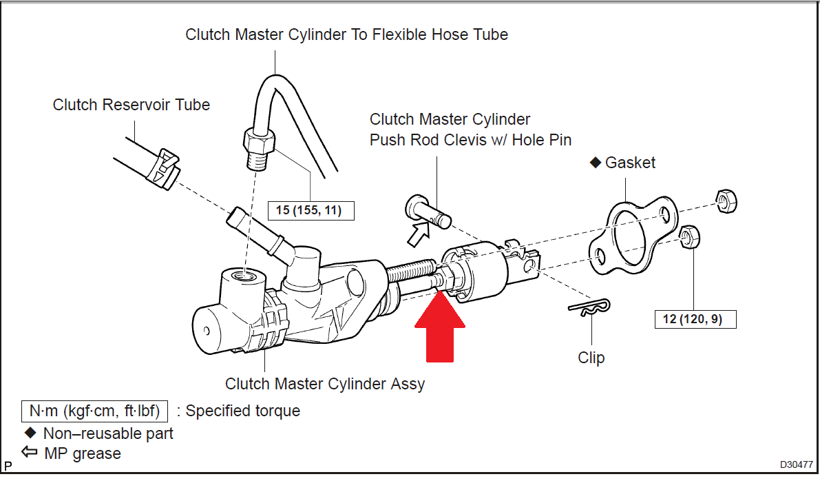

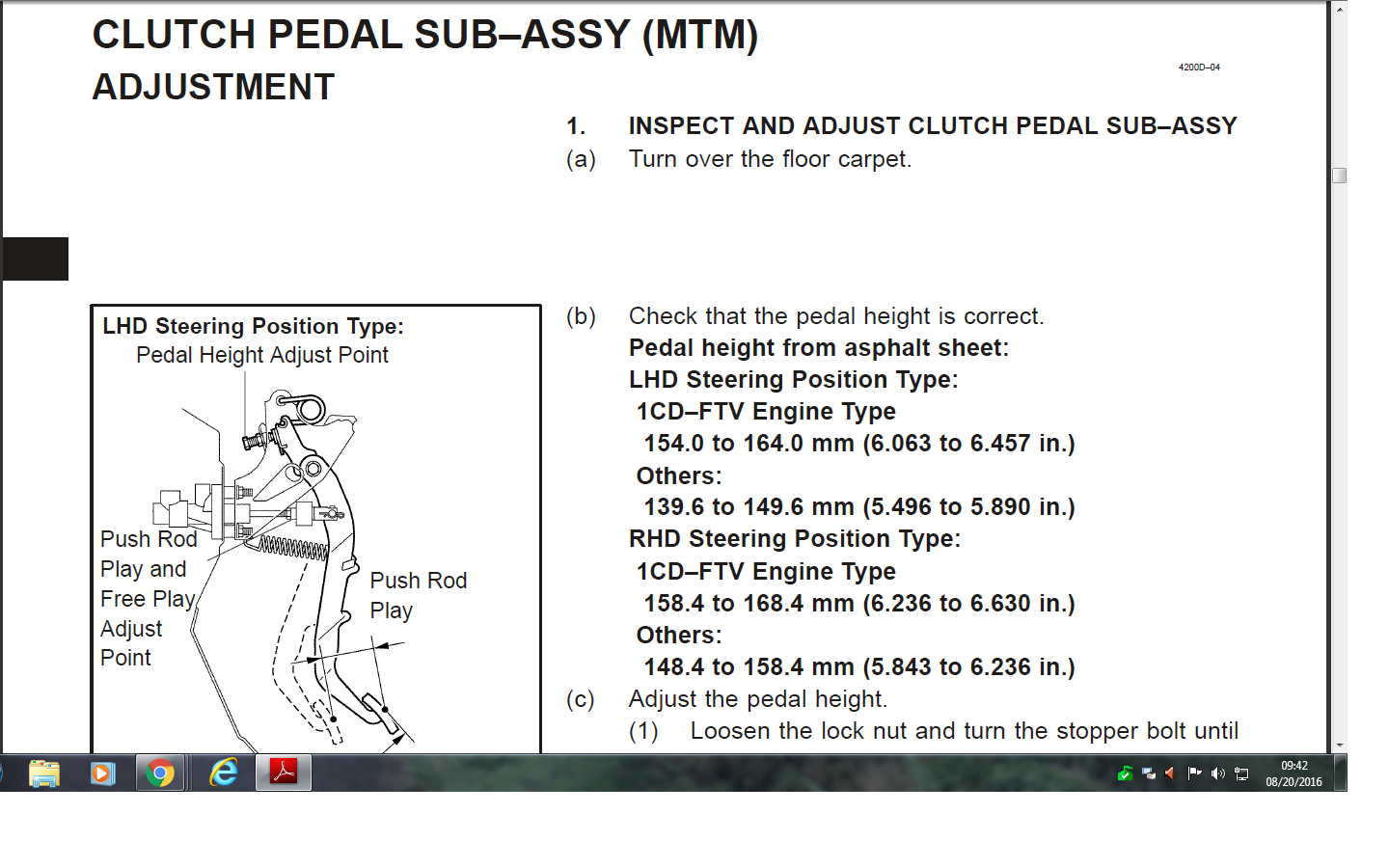

The push rod for the clutch master cylinder is adjustable by means of the threaded portion
Great info Tom. I knew from my Mk1 Avensis that there are the two adjustments - pedal height and free play. The amount of play is important, because if adjusted too much to remove any play could leave the clutch partial engaged, causing slip and more critically wear. Too much play will result in a loose pedal, not fully dis-engaged and cause difficult gear selection.
I would never touch the clutch adjustment on my Mk3, as it is linked with the EPB.
Same with height adjustment, leave unless there has been a change of component.

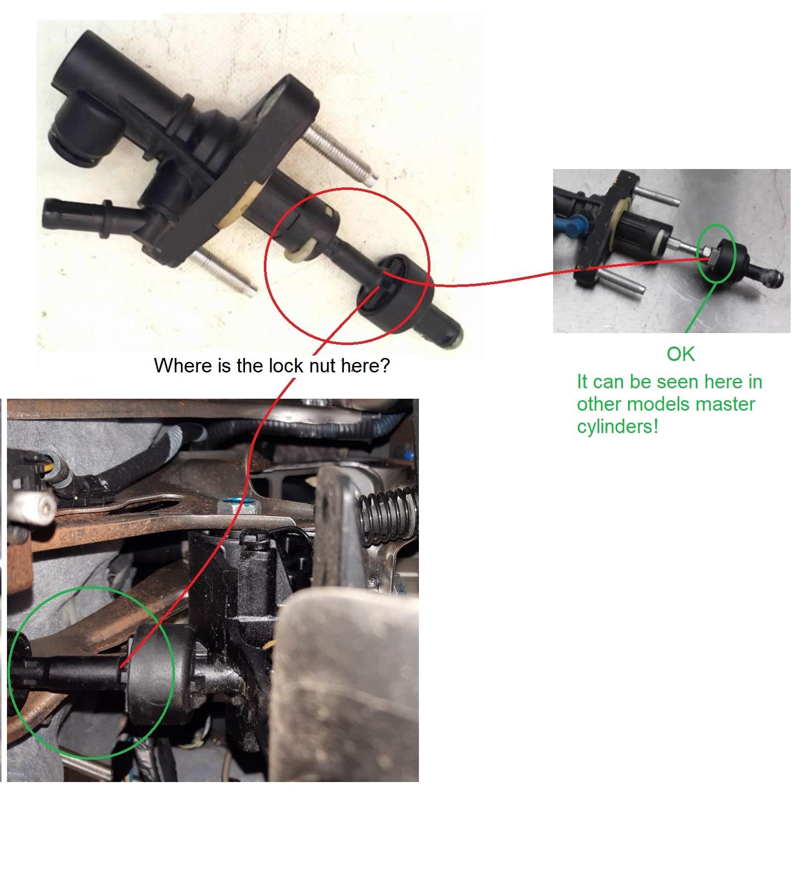

I've got Yaris 2007 and I can't find the adjust point (left part in the figure bellow). Does someone know a trick how to adjust this kind of cylinder. It is clear how to do this for the master cylinder like in the right part of the figure.
