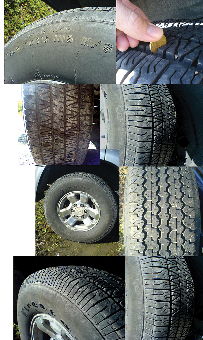

p.s
4 Firestone wilderness LE tyres for sale here in Spain if anyone is interested
