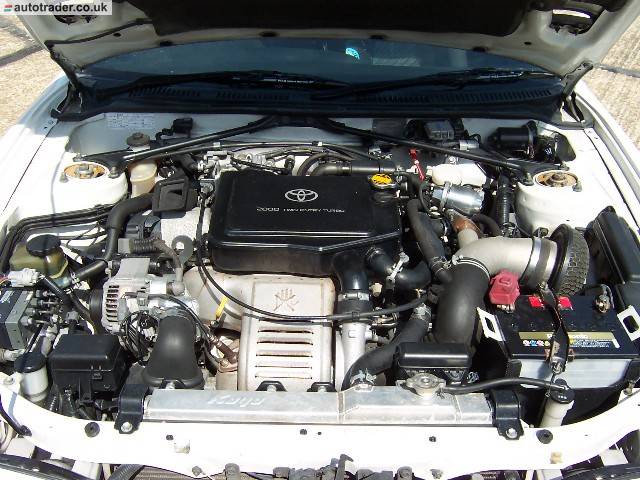

Any way let me get to the point why I posted this - I just brought a Balie dump valve with fitting kit. It came with no instructions. How do I fit it to a st205 1996????

Disconect the old DV pipe, but leave the dump valve connected up to the air box. Fit the new DV where it comes off the charge cooler.. Disconect the old vac hose, the stock valve uses a one way valve and a suck and blow pipe, just trace it back to down near the distributor and fit the new vac hose to that.... then push it on the end of the new DV.
