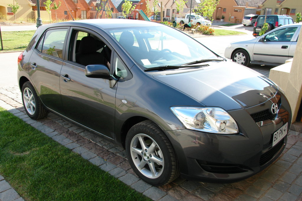

Anyway, here is a happy snap, for those interested ...
