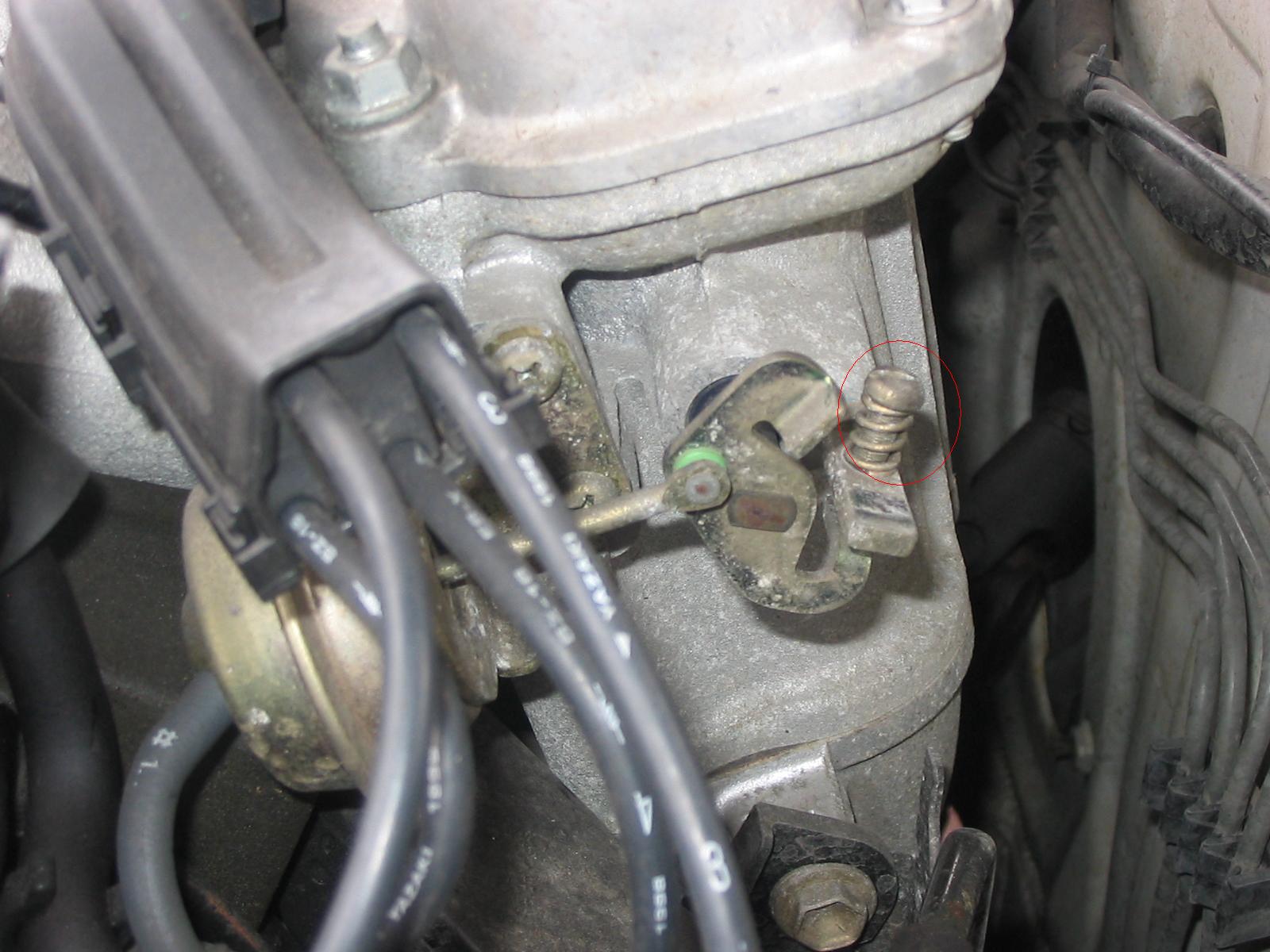

1 .On the top end block (inlet manifold?) the one thats sat at the highest point near the firewall, raised above the HT leads....... there is an adjustment screw any ideas what this is used for?

The screw is literally near the bulk head, just above the distributer if looking directly infront of car.....?

Ill try and post a pic later today, its part of a mechanical arm (control) adjoined to the right hand sie of the bulkhead.
I think a pic will help identify.

Ok I think ive sussed out what the screw is for, it's bolted onto the TVIS air intake chamber and is a control arm adjsutment for either the air control valve or acutator positioned at end of arm.
See pic attached and following link.
Ultimately im paranoid about this and need to know if Toyota will adjust this if it was tampered with at some point and or how to guage if it has?
Many Thanks.
put a small paint mark on the screw head and another opposite , if they dont line up when u get car back its been moved, i wont worry too much , moving the screw does little to how the car performs anyways. ;)
