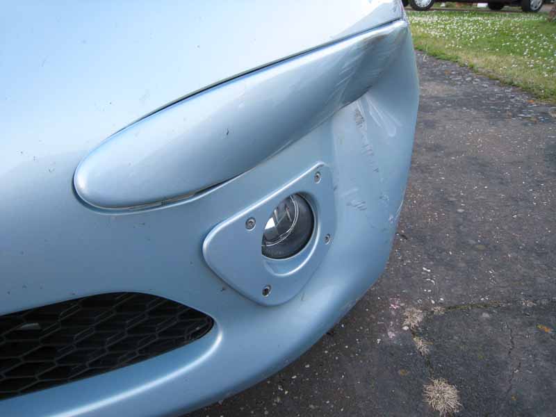

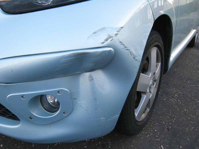

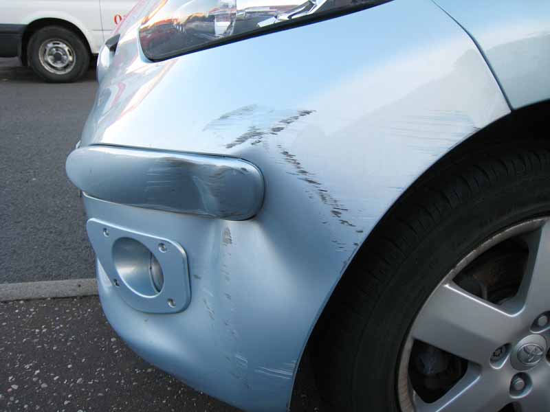

Having had a bit of a mishap with a concrete bollard and our Ice Blue Aygo Sport Plus, the front corner of the bumper has a large dent in it.
There is no damage to the glass or metalwork surrounding it, so I guessed a replacement front bumper and painting. Mr Toyota has quoted £774.12 which seems incredibly expensive to me. I am awaiting their detailed quote, but does anyone know if this sounds reasonable?
Does the Aygo front bumper come unpainted from new and if so is it just sprayed the correct colour and fixed onto the car (ie. do other surrounding panels have to be blended in as its metallic)?
The other thing I'm wondering about is having the dent pulled out of the plastic bumpers and getting it repaired by a bumper repairer (althought I'm not sure this is feasible).
If anyone can help me on this I'd appreciate it.
Thanks

I have repaired similar damage to mine in the past using a windscreen suction cup and pulling it out and replacing just the corner parts.

Can you get behind it and push it out from behind without splitting it?

As you've advised I will get some other smaller bodyshop quotes and find out from a bumper repairers if this can be pushed out. I've seen the article on here explaining how to remove the front bumper and it looks pretty simple (none of this stripping down). Toyota list a new front bumper as £110+VAT. eBay has front bumpers, although none in my colour and I can't seem to work out what happens with the front fog lights - surely these holes are pre cut?
At the rate of the first quote, my car would be written off if it had damaged any metalwork?
The lights are usually fitted after explaing why the holes aren't pre-cut. However it would be much easier to just try and repair it best as possible and then live with the scratches or re-spray the original.

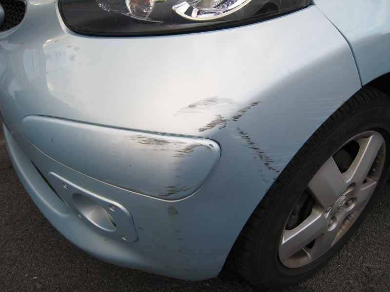

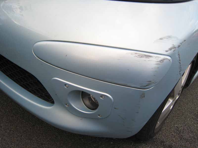

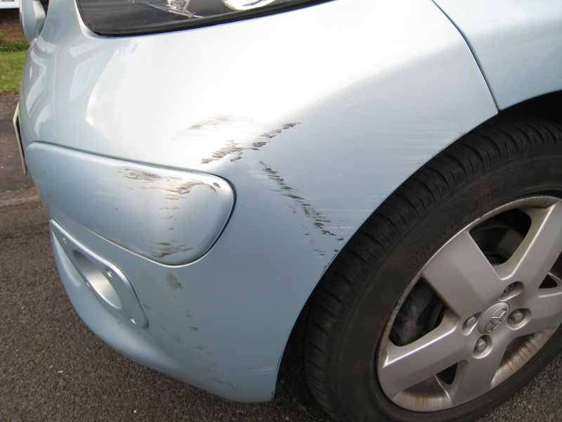

We approached a small local garage who have initially started to sort the problem with the front bumper.
They have heated up the problem area today and put the bumper back into shape. I've attached the photos of what they've achieved which is pretty good going so far.
Just shows you what can really be achieved without replacing most of the front of the car!
I am awaiting a written quotation for sorting out the scuffing and maybe a new corner piece, which they have verbally said would be around £200 all in.

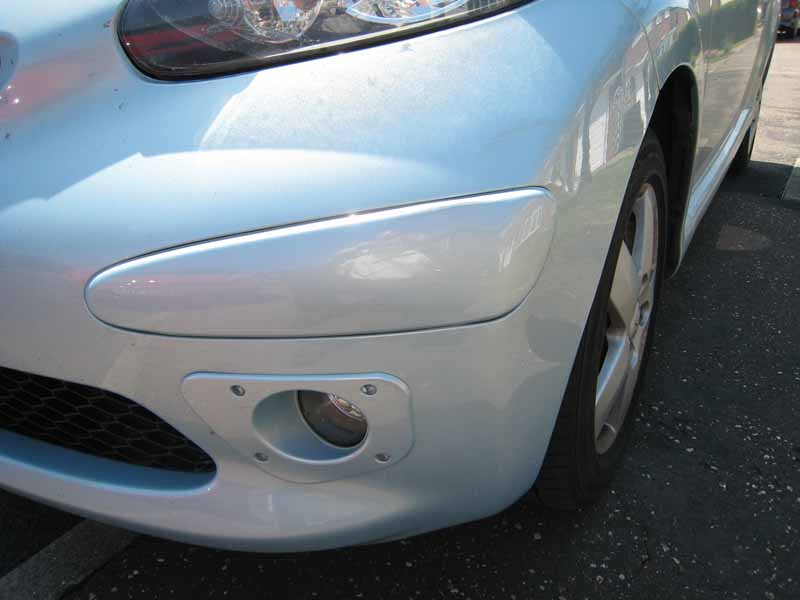

I didn't receive the promised quotation for the paintwork repair, so decided today to grab my trusty bottle of Autoglym Super Resin Polish and Mr T's ice blue touch up paint.
I think you'll agree that the clean up and paint touch up has gone pretty well - apart from a minor scuff mark, the difference from the photos just after the prang and now is good.
As suggested here, its always worth spending time approaching smaller garages for repair (rather than rebuilding your car) and also devoting some work yourself to cleaning up any damage. Still await a bill for heating up and pulling the bumper back into shape (expected small cost) and some elbow grease (£0). Better than spending just under £800 anyway!

You are a legend. Really nice job.
Yeah good job. :)
