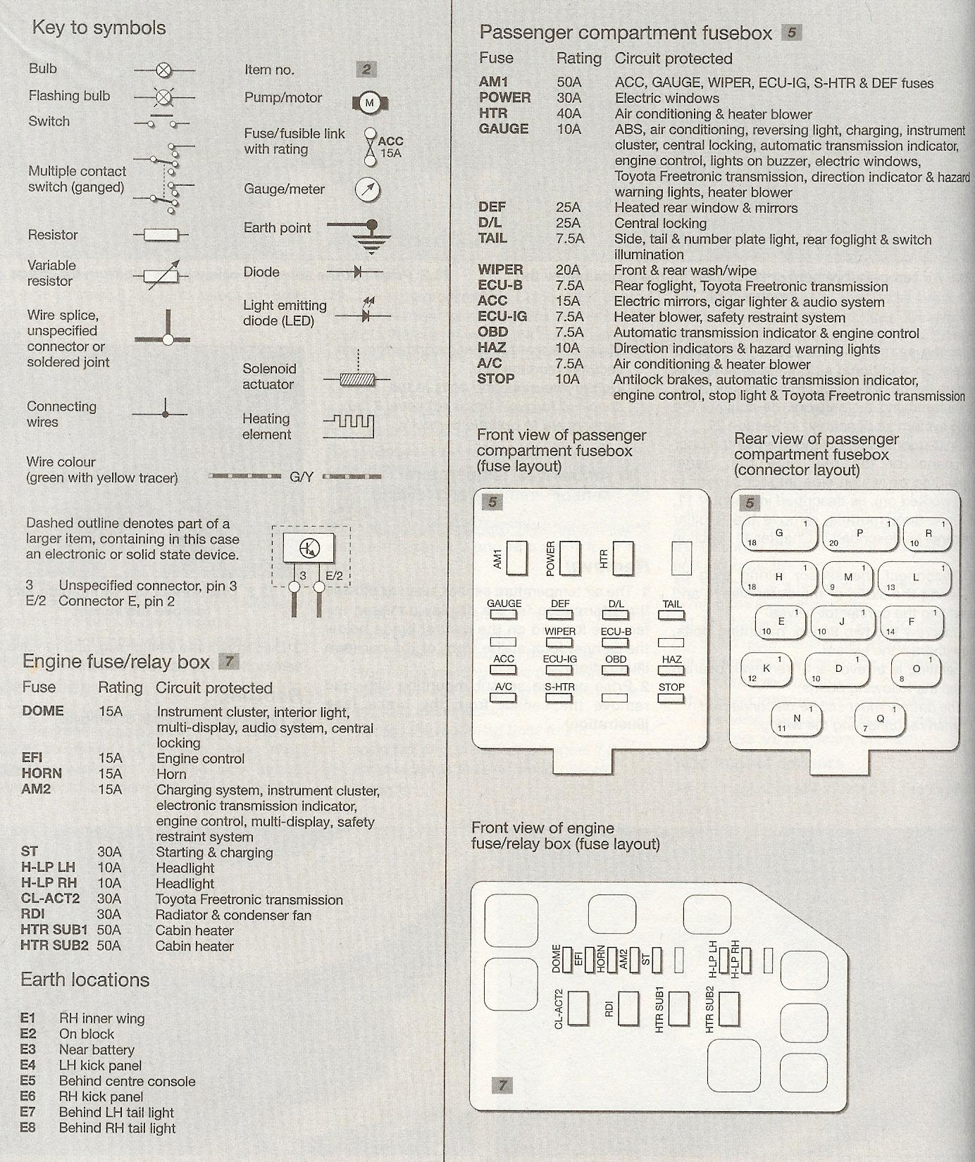

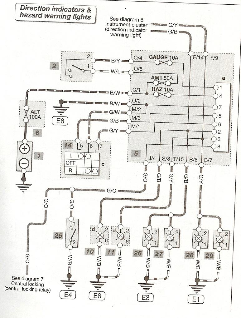

on investigating indicator fault, ive now lost all including hazard function,. iam awaiting a haynes book from flebay, does anybody know what fuse it is and relay

Are these attachments any help

thanks buddy i found the 10 amp fuse had blown, just have to find where it shorting out now

sorted it was because i had removed the stop light which was broken, when i removed the lens cover you could see the circuit.
