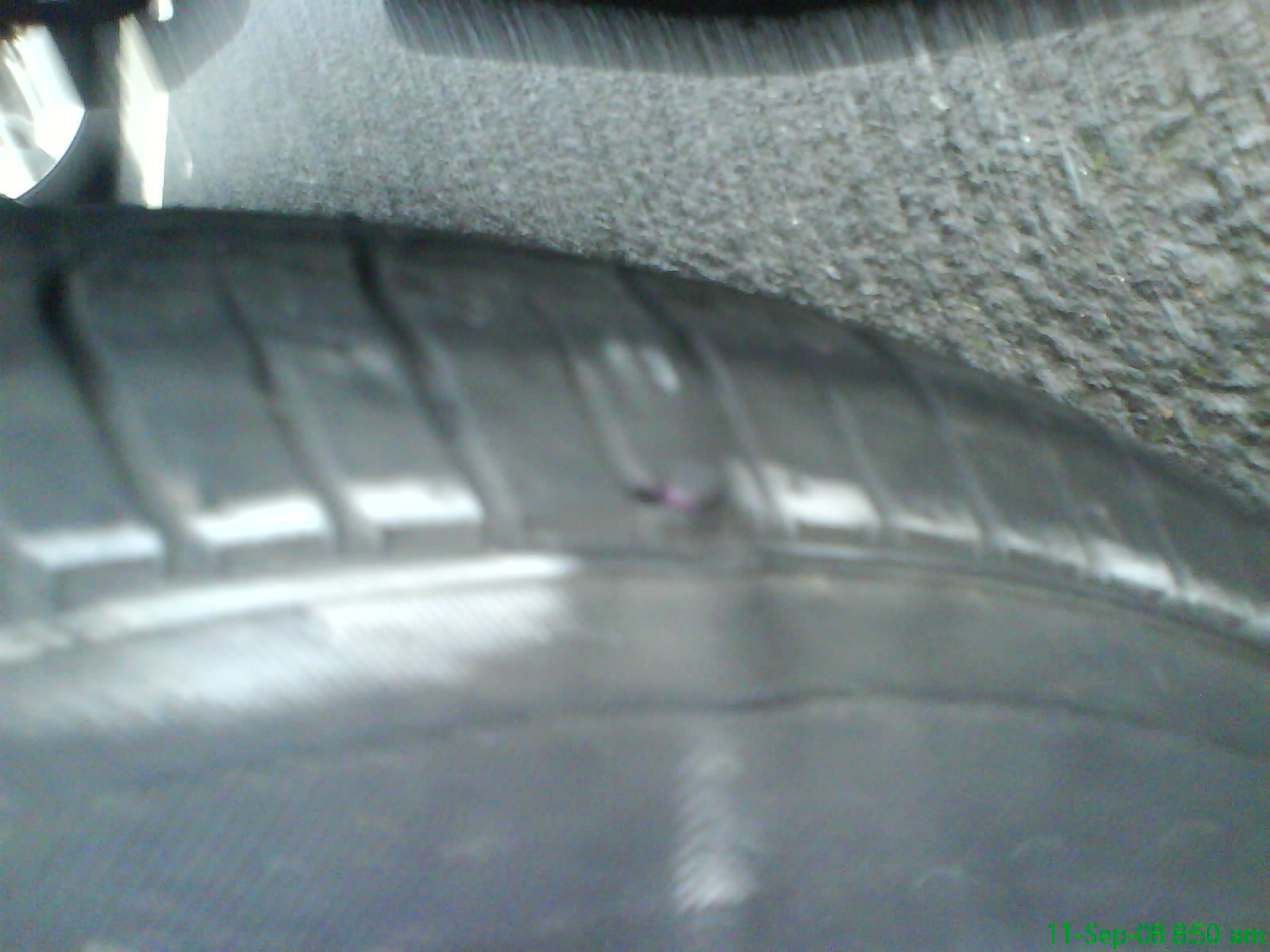

hi i got a puncture in my new tyres and had a bung put on it .. its not in the side wall, but near it and there is a buldge.
any ideas is this safe?

i wouldnt risk that, when you think about it your using that spot when cornering. id say its a new tyre. your supose to get em changed anyway i think when you have a bulge in it.

I got the repair done, but it has caused this bulge now .... I had hoped they could put a tube in the tyre ..

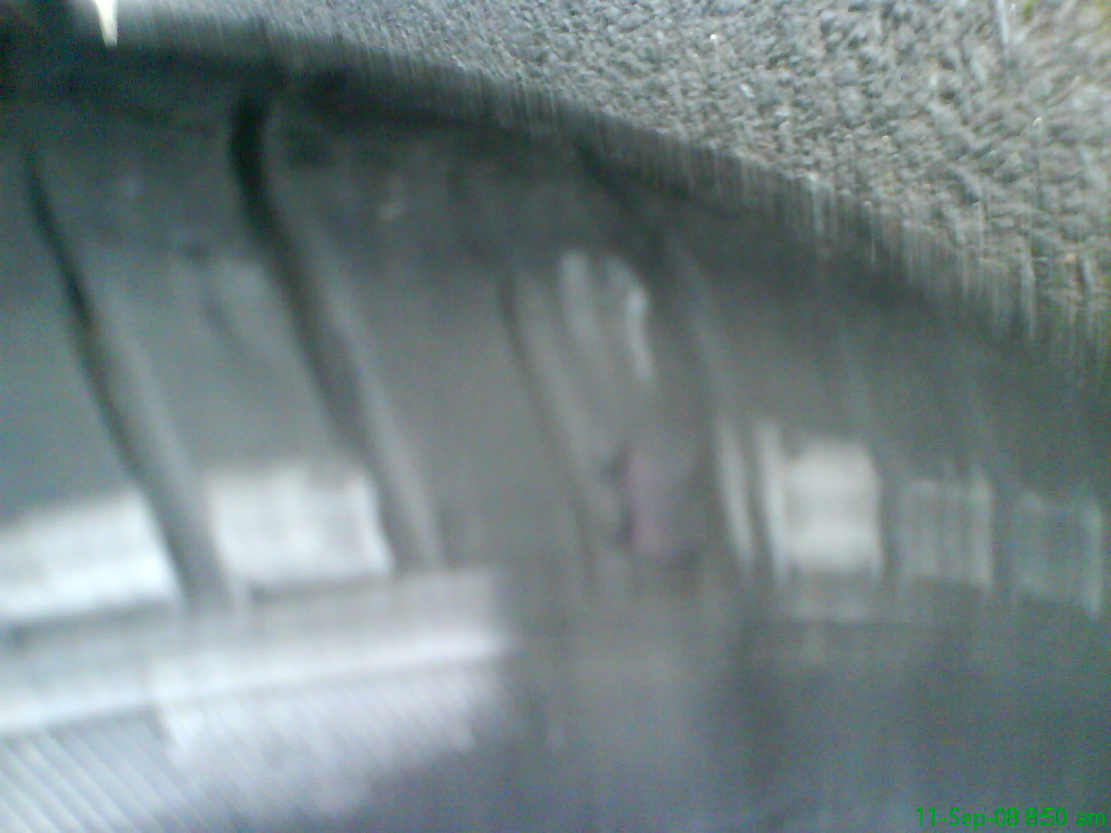

If you look at the pic, wot do u think? the nail was in the top part of the tyre .. close to the side .. I checked with a genuine garage and they assured me the repair is legal. Should I chance it?
Instant MOT fail.
And dangerous..
Replace asap.
Instant MOT fail.
And dangerous..
Replace asap.
thanks for the advice .. can you see from the pics what i mean ... dont think it looks as bad in real life, but still.
DO you think its too close to the tyre wall?
Thing is the car is only 1 yr old
I'm really surprised they repaired it!!!? A definite No-No! :eek: Anything within 35mm of the sidewall is a 'throw-away'. Sorry.
Ciao.
Have to agree with the others here, that tyre should never have been repaired, and no you can't put a tube in it, that would be dangerous as well, just get a new tyre
Pete
As a tyre fitter I'm absolutely shocked that ANY competant tyre centre/garage would have repaired that, they have not only put your life at risk... they have put the lives of every other road user/pedestrians life at risk too. The bulge in the tyre is there because the structure of the tyre has been damaged, the nylon cords that support the sidewall have snapped, the air pressure is then only pushing on the rubber causing it to expand outwards, next step is a blowout.
