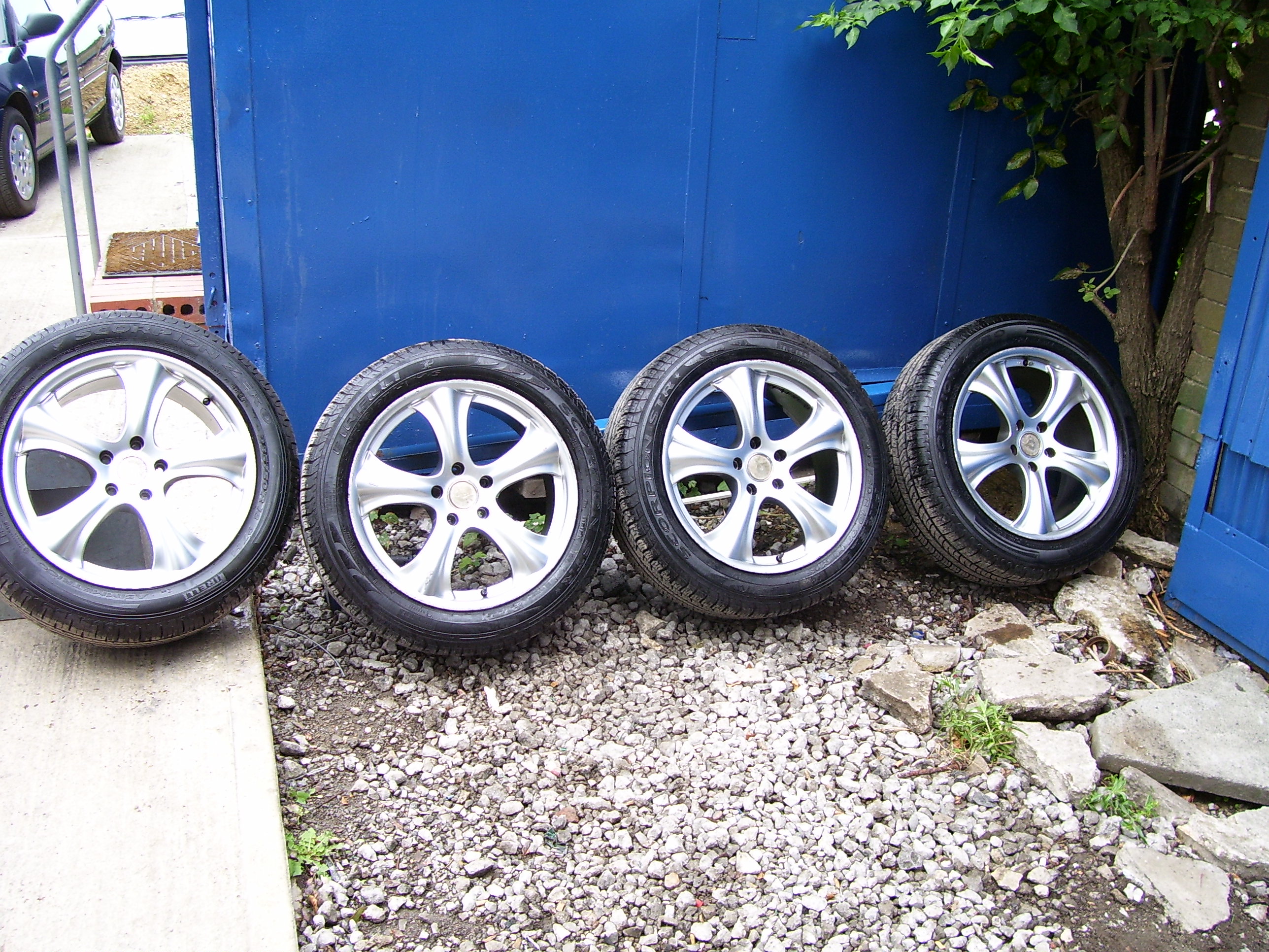

Hi, I've a set of 4 x 18" alloys with 235/50/r18 97H, Pirelli Scorpion tyres that are only 6 weeks old. the rims have a few scuffs but are sound....I'm asking around £600.....m...they are all ballanced and ready to go....with the spacers as well...m. :D

Got a picture?

attachmewheels_001.jpg][these are they......if it's worked....m.
