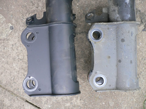

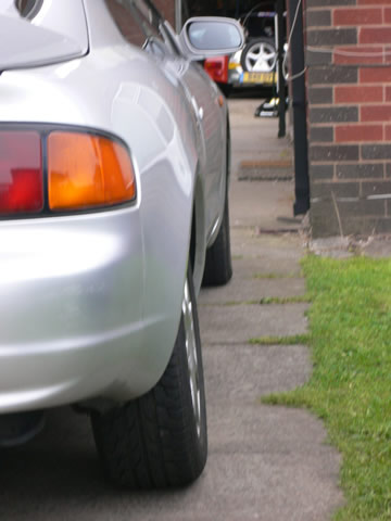

Mechanic fitted the new LH & RH struts but found that the rear wheels were severly cambered in at the top and out at the bottom, rendering the car undriveable.
Took the new struts off again and compared with old ones and found the bolt holes were not in the same place.
On the old struts the bottom holes are closer to the strut, the top holes are 5mm further out.
On the new stuts the top holes are closer to the strut, the bottom holes are 5mm further out.
Contacted Parts Plaza who claim that the parts supplied are definately the right ones for the year & frame (0050910) and no-one else has had this problem. My Celica does not have super-strut suspension.
Possible scenarios include:
1) Faulty batch of struts with bolt hole section welded on upside down.
2) Supplied with super-struts instead of standard.

We had a look at that option but the new ones have a collar which is crimped securely onto the main body, there is no nut.
The old ones are a sealed unit, no nut there either.
The part numbers off the old struts are 48530-2B390 & 48540-2B390, when I Google these they cross reference as being KYB parts 334125 & 334126, which are the new ones I've got, which don't fit.
What the heck is goin' on folks?!?

I managed to solve the problem by buying new BOGE struts and returning the KYB struts which were causing the wheels to camber in.
The part no.s are 32-C78-A and 32-C79-A incase anyone else has a similar problem.
