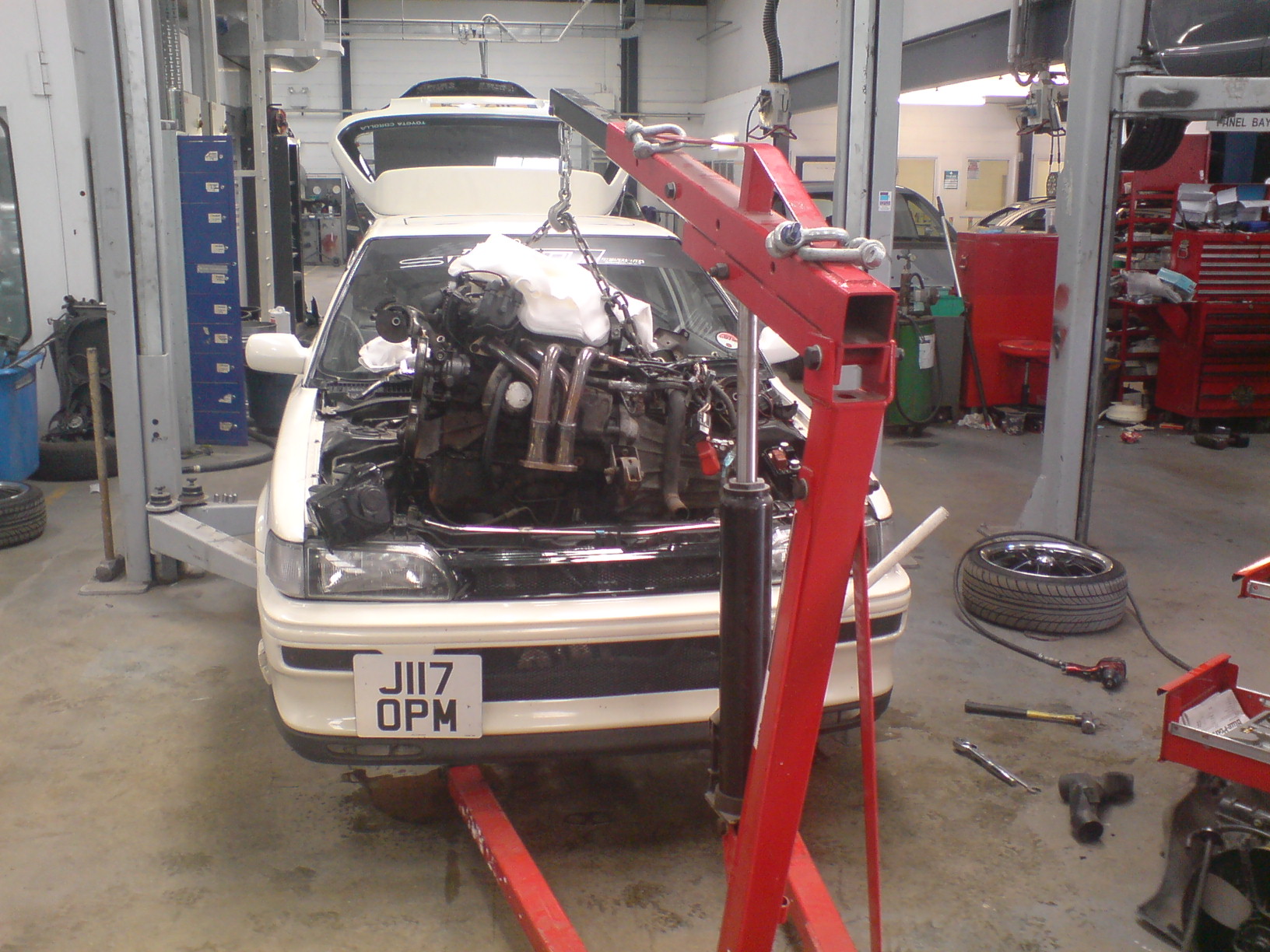

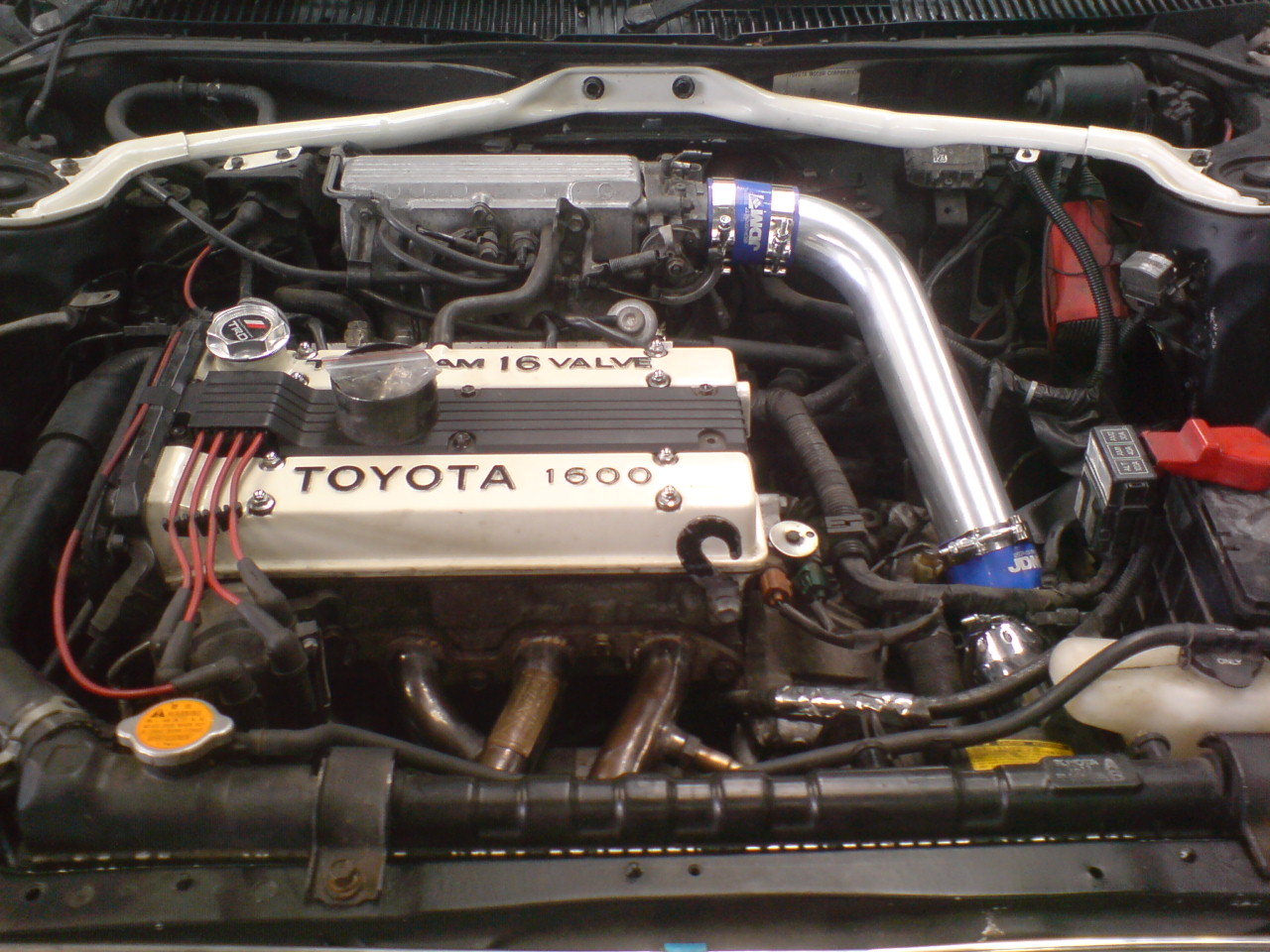

mr poor rolla :(

nice lookin rolla doesnt look as bad as mine did during the Shell up rebuild

nice lookin rolla doesnt look as bad as mine did during the shell up rebuild
Wow you have 1 amazing corolla!
