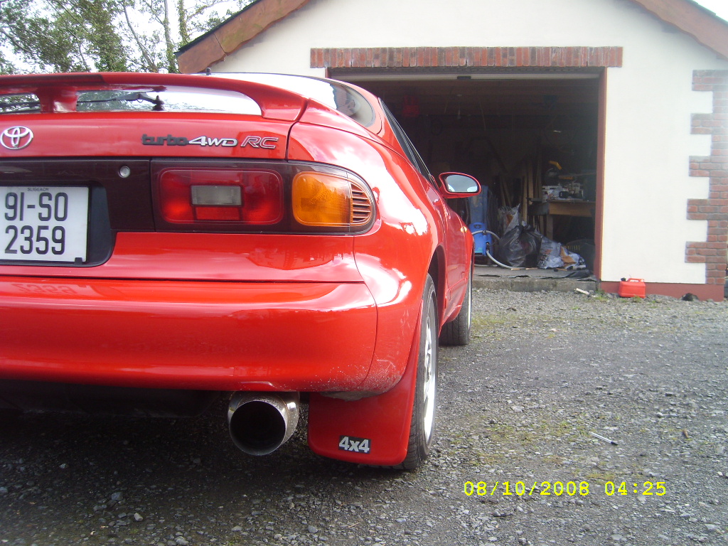

its amazing looking car though just out of garage after giving it a full respray ,you would want to see the looks she gets :D its the nicest car around.
