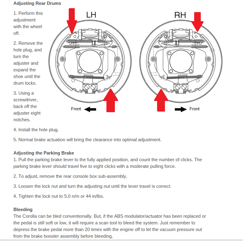

If you're talking about the OP's complaint about a creaking noise when reversing back slowly, have you considered whether it's the handbrake making the noise?
On your model the handbrake operates on brake shoes inside a drum which is incorporated into the rear disc. The shoes have a leading and a trailing edge (see the attached picture where the leading edges of the shoes are highlighted by red arrows). These leading edges are meant to assist the braking force when pulling on but also incidentally help to release the brakes when initially pulling forward after the brakes have been applied and the vehicle left static for a while. Otherwise there is a tendency for "stiction" of the shoes against the drum. So when you reverse the car after it has been parked with the handbrake on you might get a creaking noise until the shoes release.
Note: this picture is not of the Auris brake, it's a just to show leading and trailing edges on brake shoes.
post-140480-0-26552000-1452336510_thumb.
Since Auris replaced Corolla in 2007 no Auris features parking brake shoes, the hand/parking brake cables act on a lever on the rear calipers pushing the pads onto the discs.
