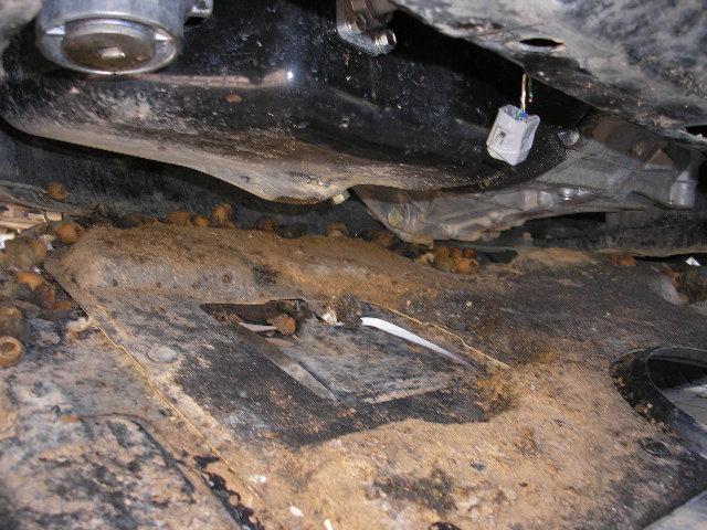

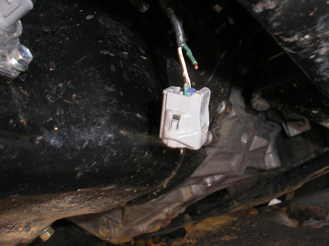

Decided to have a go today, and managed to fix it, so far the oil warning light has not come on yet, so I am very pleased with myself, it was a bit of a squeeze getting under the car to get the cover off and a bit tricky to get connector opened to get the remains of the chewed cable out but all sorted now so thanks for the help and advice,
Here are a couple of pics of what I found when I removed the cover, bit of a mess, all cleanded up now.
BRILLIANT JOB! You've got to be a genius with a soldering iron. Congratulations :thumbsup:
Thanks, I have a small bit of experience with a soldering iron, but a good quality Iron, and good solder are half the battle. Could have done with a bit more room to swing my arms around, but having not been under the bonnet of any car too often I must say there is great satisfaction in in getting something like this, however small, to work out.
Yeah, far easier to back out the crimps from some connectors than others. Glad you are sorted. Thanks for letting us know :thumbsup:
