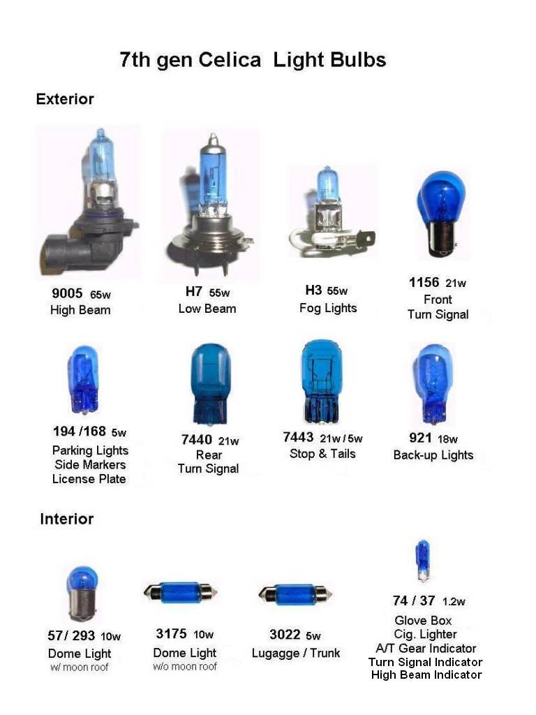

does anyone know what size bulb goes into the cabin light? (the one on the inside roof)
thanks
thanks
yes mate, there you go
