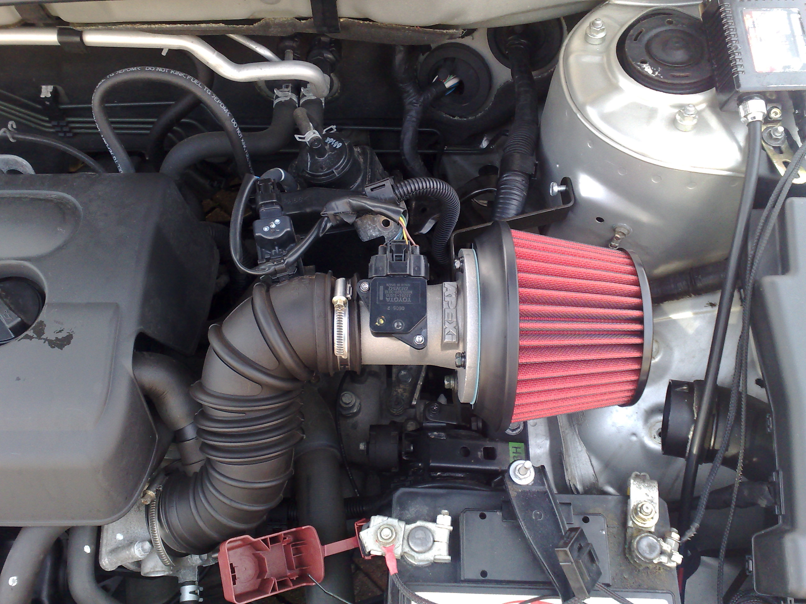

get a picture up of what you have put on. In the mean time take it off and replace your standard air box see if the light goes. Also which apexi filter is it? is it a universal filter because the corollas need a specific one for the sensor near the airbox (maf)
Get a photo up and it will be easier to tell.

Get some pics up mate.

Here's some pics:

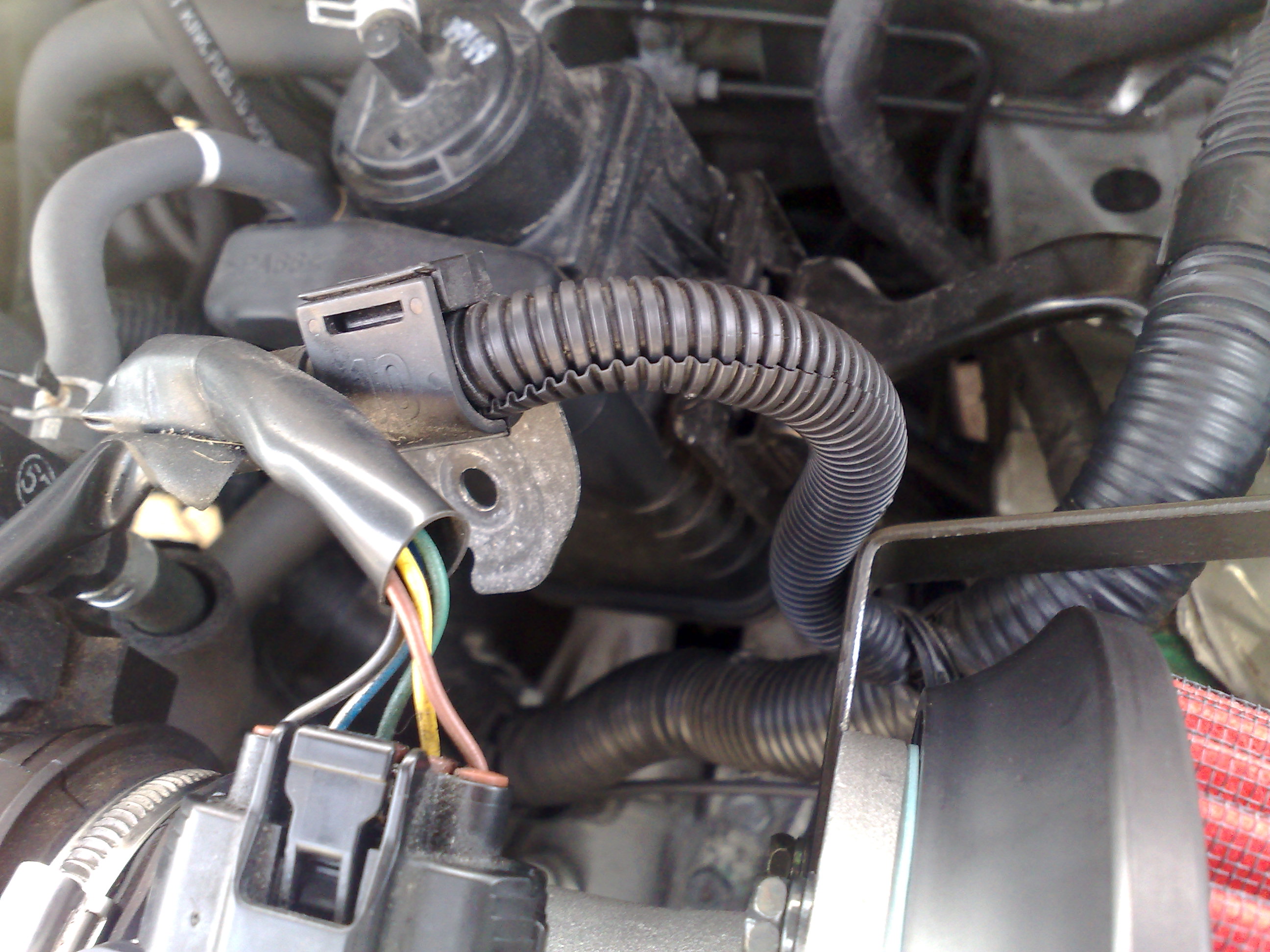

After looking more closely though, I found two cables connected to the MAF damaged:

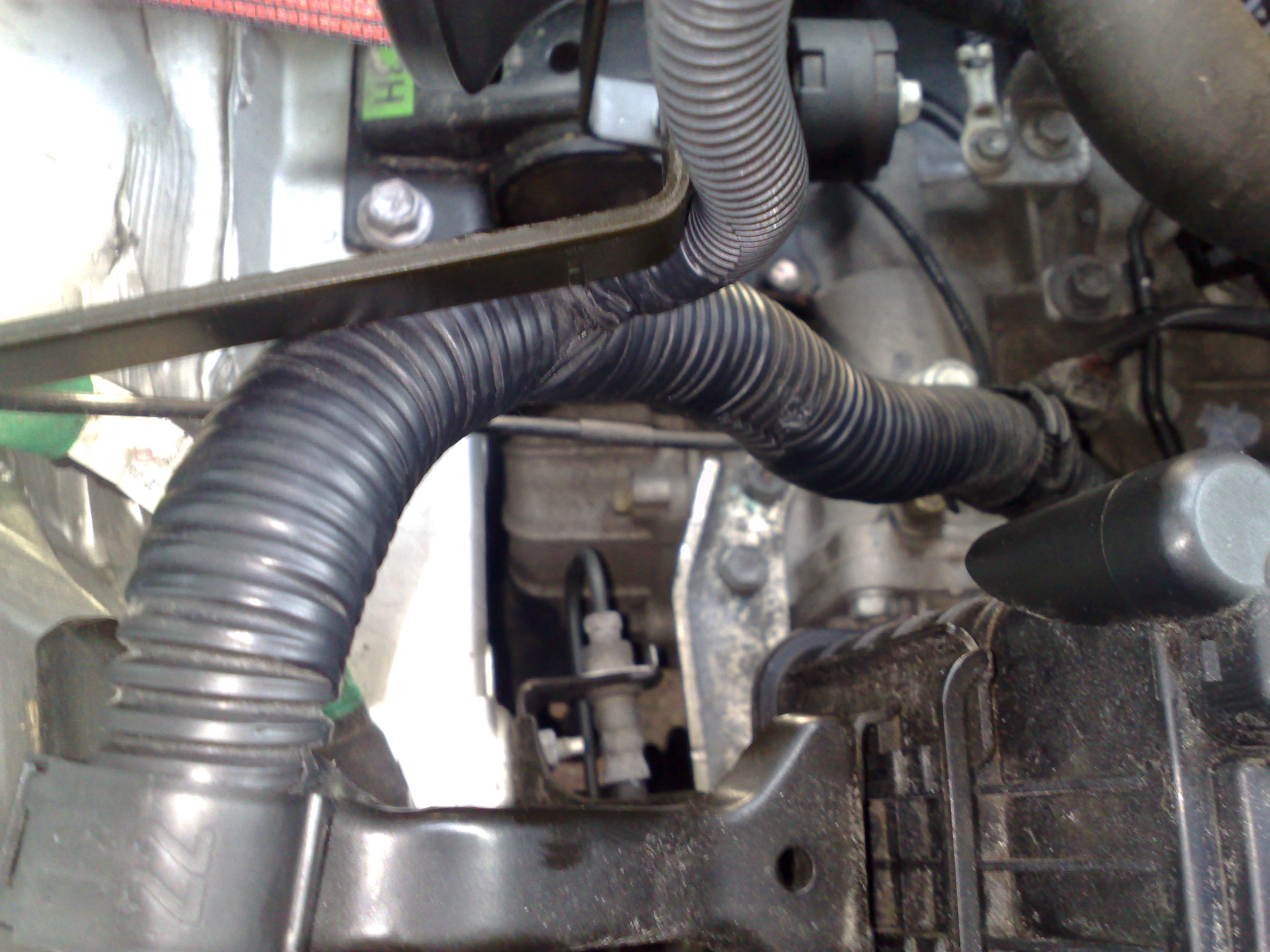

and also in the middle here:

Have the wires actually come out of the MAF? Or are have they just got nic's in them? Have a look at the Definitive Part Number thread (the last post by me) and you will see an easy fix if you needs to replace the plug and wires.
Did you have to stretch the plug to reach the sensor?
