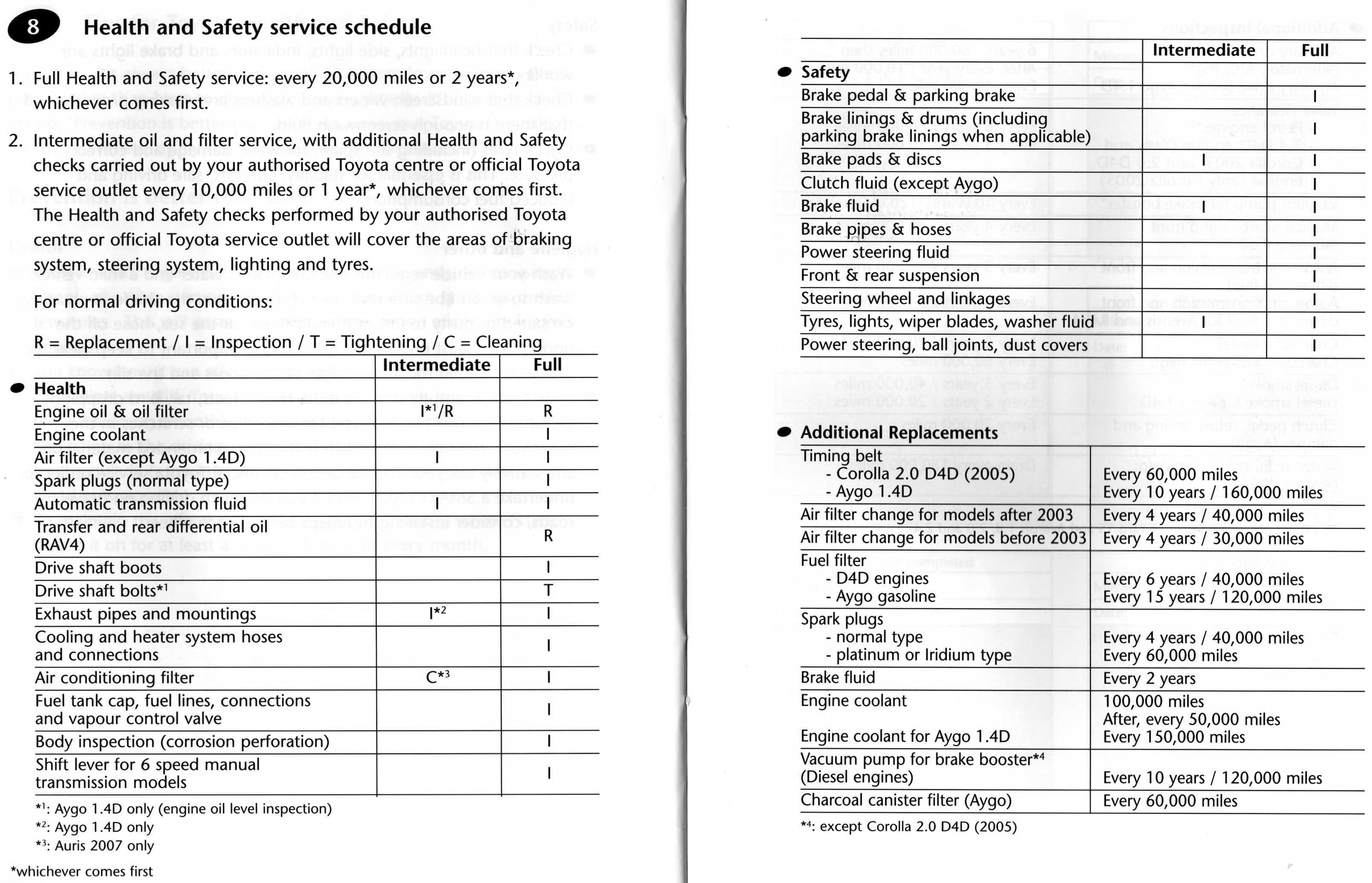

Hi Guys ~ I wonder if any one can help with a question on avensis service, i would just like to know what is expected with a 30,000 mile service. what they check etc. i could not see anything on the site that had any ref to this.
I have a '55 plate 1.8L Toyota Avansis.

Good question, I too am approaching the 30k service with my 03 t3-s estate also 1.8 vvti.
Hi people,
i will probably have the full service on the 40,000 mark, as per the book. But just for now i'll just do the oil change , oil filter and air filter. is this a good idea and if so what is the best grade of oil to use? and is there any thing i should look out for particular.

I have attached an Avensis Service Schedule. Fitterpost-66293-1234383393_thumb.jpg
