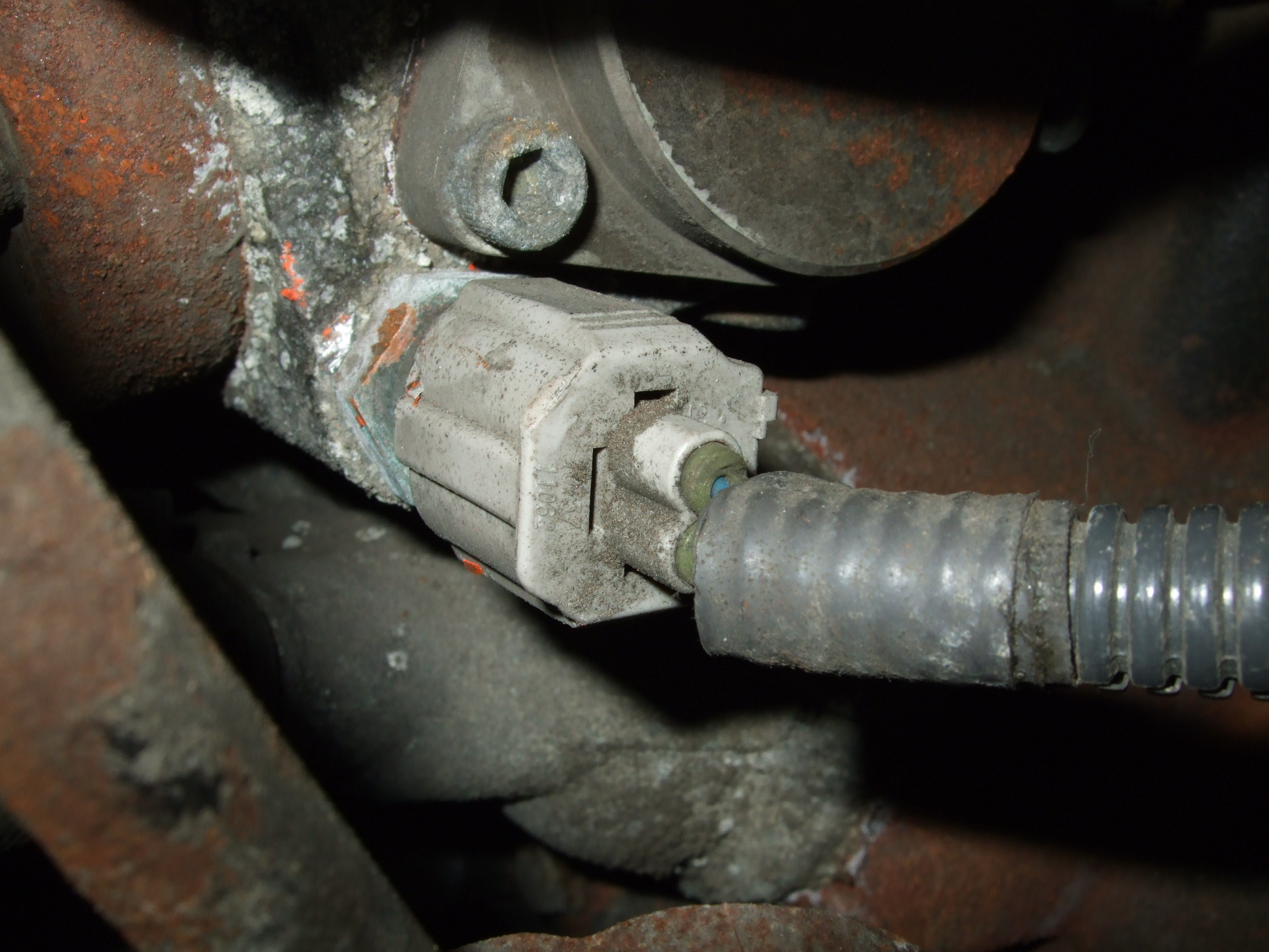

Hi are these the 2 scv you talked about on the pump.
Hi Andy
In case both are located on the injection pump then you are correct.
Good luck + up date us with developments.
Cheers/Igor

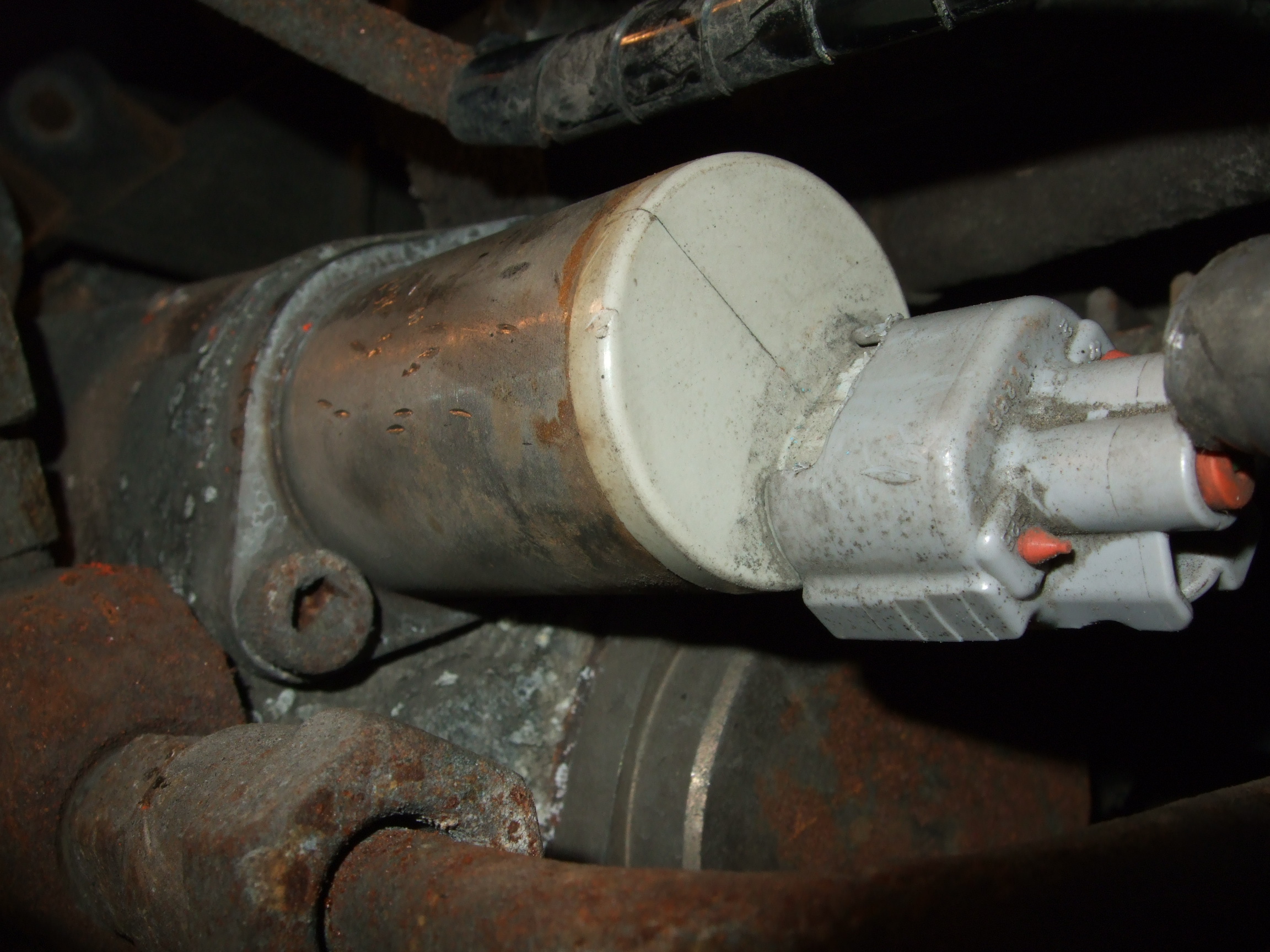

Hi there for some strange reason im going totally different to views and i may be wrong but trying a new Starter motor.I dont know why but i have gut feeling this is the problem.I have read in other forums posted by goodison who seems to know his stuff about a same problem he diagnosed with the starter motor.
He says in previos post "your car has a faulty starter motor,replace it and the fault is cured,fault is caused by scratching on the armatuer shaft which causes a high resistance on the electrical circuitry, starter will be turning quite normal when you start warm, but the excess current draw shuts down the injectors hope this helps you "
I think this maybe true of mine and have new starter on order,if im wrong then its only a starter if im right im quids in from replacing scv valves .
This is a stab in the dark for me but goodison is a toyota technician and seems to know his stuff on toyota matters.
Will update you and ill be jumping for joy if im right, in my decision.
