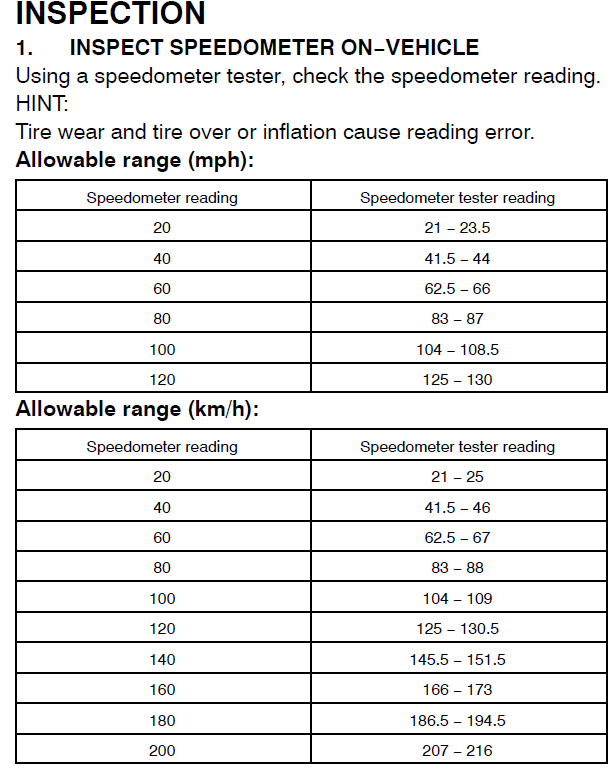

As you can see from this below table, there is some allowable deviance...
However, your speedometer shouldn't show more than you're actually driving. This would mean that your combination meter is faulty, or the speed sensor produces more pulses that it should. The speedometer would be showing nothing or a very fluctuating speed if the wiring was faulty.
I would recommend visiting a garage to get this fixed so that you won't get any speeding tickets. I doubt the police will give you any slack for having a faulty speedometer.
This table is for the rav4.2 (2001-2005)
