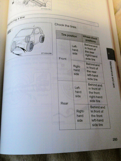

I bet some did not know the iQ comes with two wheel chocks, they are under the box under the rear seat.

yes they are mentioned in the manual they are for when you jack up the car I think to put behind the unjacked wheels to stop car rolling.
