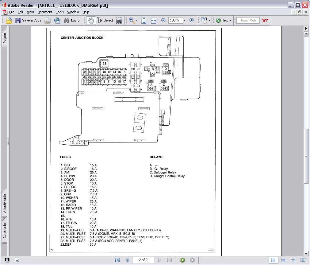

It sounds like one of the multifuses in the cabin fusebox has blown. There is a panel by the drivers left knee in the centre consol that just pulls off with a fusebox behind it, check fuse no.20 in the attached pic. You'll have to get these replacement multifuses from Toyota as they're not generic.
thanks alot mate, that sorted all of the problems out except for the climate backlight. U reckon it just mite need its bulb changing?
thanks
Yes mate, it will be the bulb that needs replacing. It's been heard of many times before.
