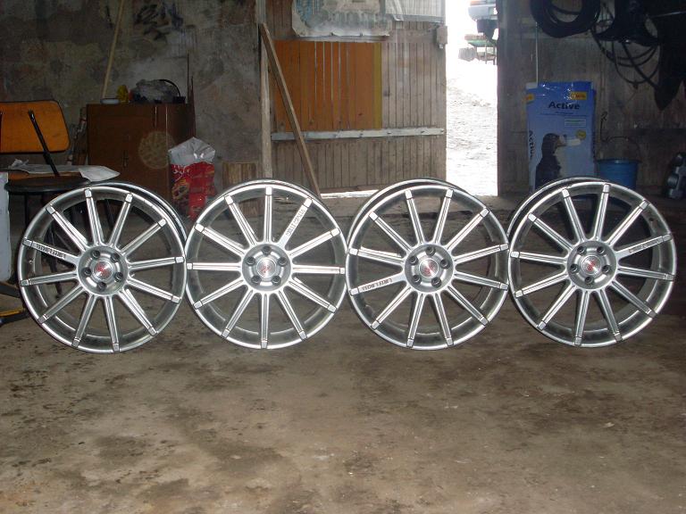

I have a chance to buy disks on my auris for low price ~200$, but the big problem is that the seller doesn't know will they fit auris. All he knows is that they are 18", and they couldn't fit A8. So i ask sm1 to help, if sm1 know or saw size of disks or where can i look on internet. :(
The wheel must be 5 stud 114 PCD, offset 35-42 with 225/40/18 inch tyres. As above, the markings on the reverse of the wheel will tell you
Kingo :thumbsup:
Thx all, ill have a chance to look at them at Friday with my own eyes :) The man is leaving in other city ~200km from me. I'll post here result and foto if i buy them ;)

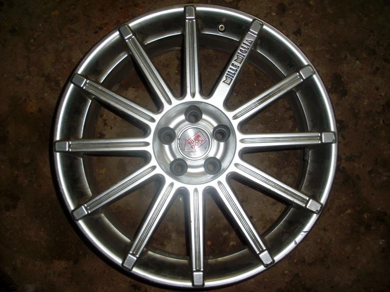

Just got some parameters form the back of the disk > MM-T12-18 / 7Jx18H2 / S31 / ET35 / 597.94 < Can sm1 help me to figure put what this mean? :huh:
Wheel is 7 inches wide by 18 inches in diameter and its offset is 35 mm. The offset's within limits but doesn't give any information about the bolt pattern. Don't know what the rest means.
