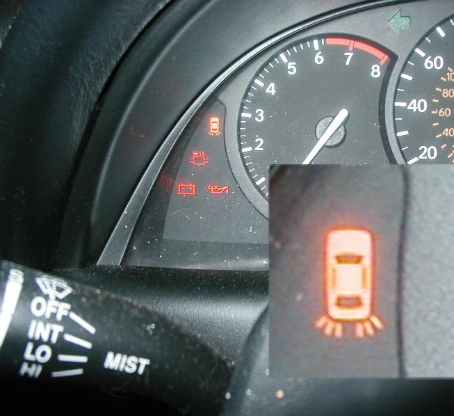

Also there is a light contantly on the dashboard it a orange light car shape with six lines at the bottom 3 at each side was wondering what this was as i cant turn it off.

light on dash means a rear bulb is not working or poor earth .

Hi checked lights on back of car there are 4 red lights on all the time 2 each side is this right.
Or should it be 1 each side with brake lights not sure on this one.
Orange light is supposed to signify a light defect howere I changed every bulb and still could not make the light go out.
I have been informed that this is something to do with the addition of a sepaerate fog Light for uk requirements
Either way it wouldnot go out so I removed Dash and took bulb out - to solve problem for me
All the lights work as they should think i'll leave it not doing any harm just wanted to know what it was.
