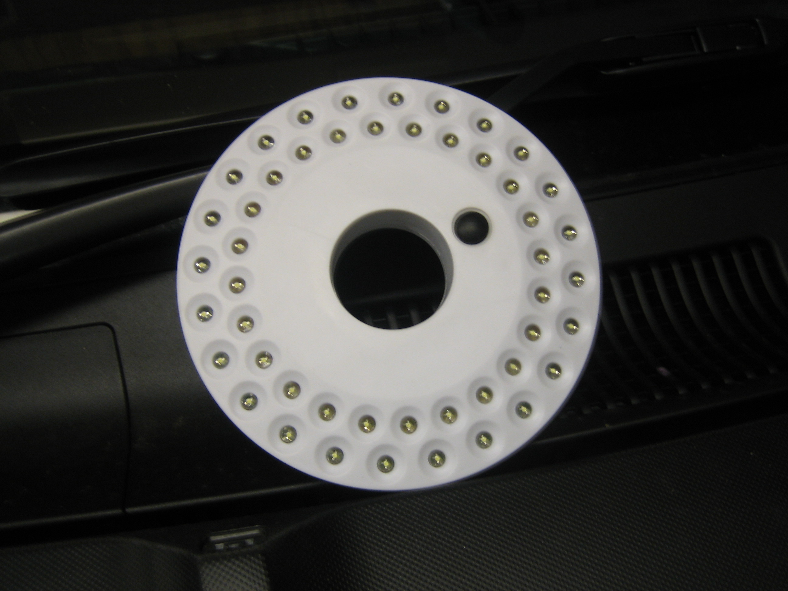

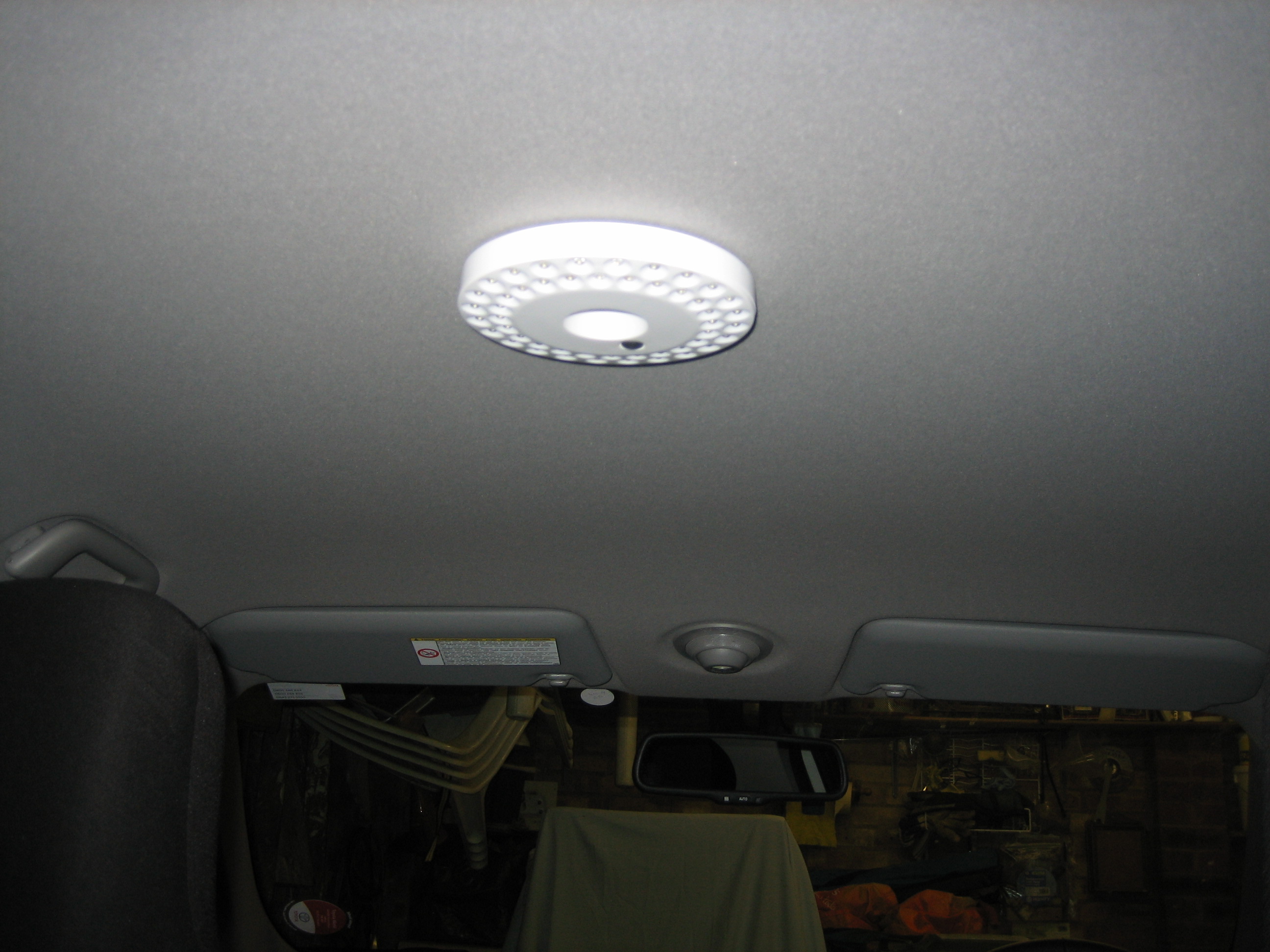

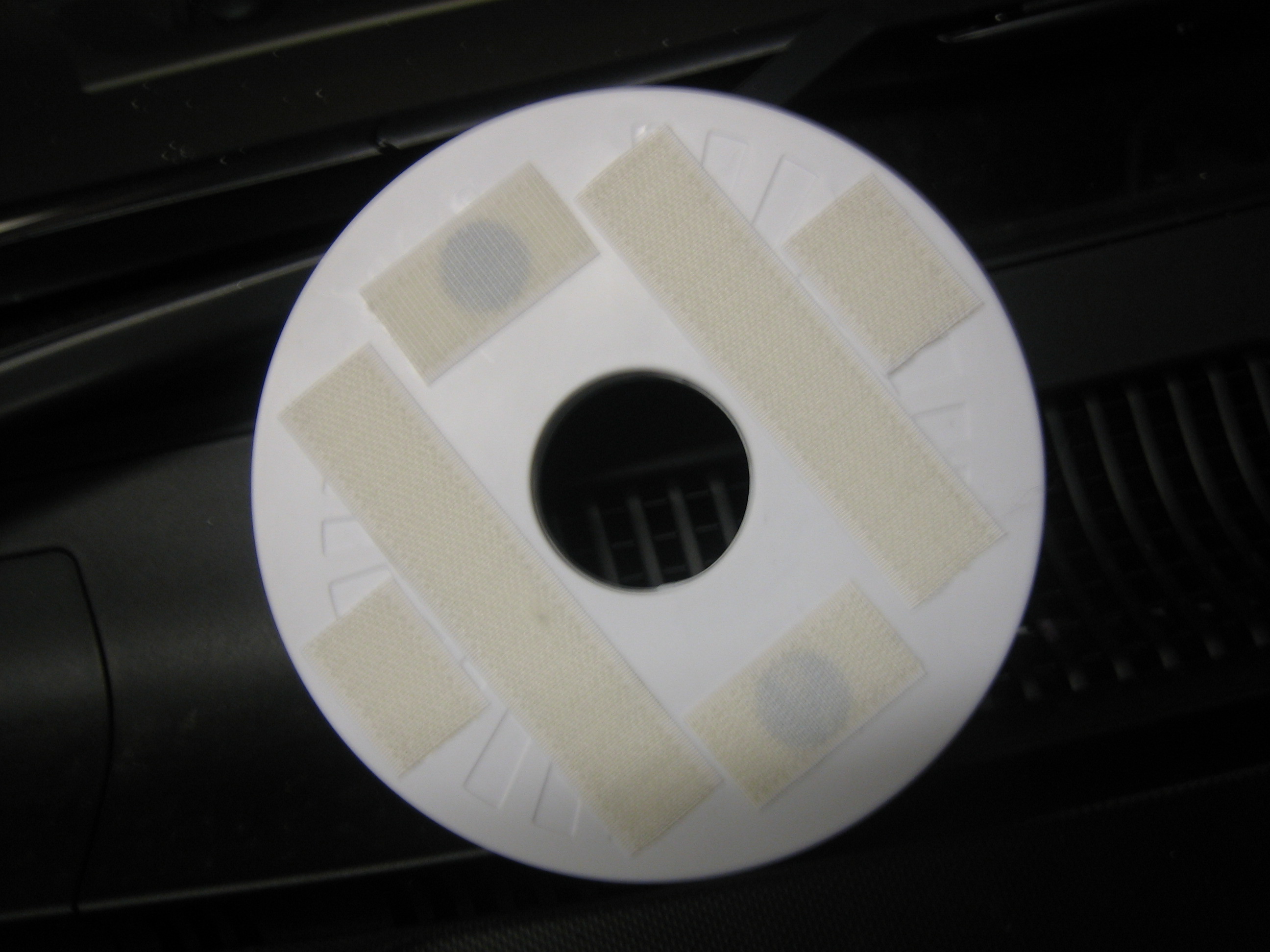

But I have a solution ! I was in ASDA the other day , and you can buy a Battery LED light ( see pics ) for £3 plus some batteries. It has got magnets in the back and a hook device, but there is no way you could stick it onto your headlining ... or is there. Velcro ! I had some self adhesive Velcro strips ( the hooks ) , so I stuck them on the back. Strangely enough they attach really well to the head lining, just push it on & give it a little twist to & fro - no worries. The results are pretty impressive - see pics.
I have one shot with the IQ light on & one with the Asda light on. Ok so you have to press the button to make it come on .. . . anybody know how we could wire it up to come on with the hatch opening... It is all just a bit of fun really. . . but I really did need a light in there , and it does the job !

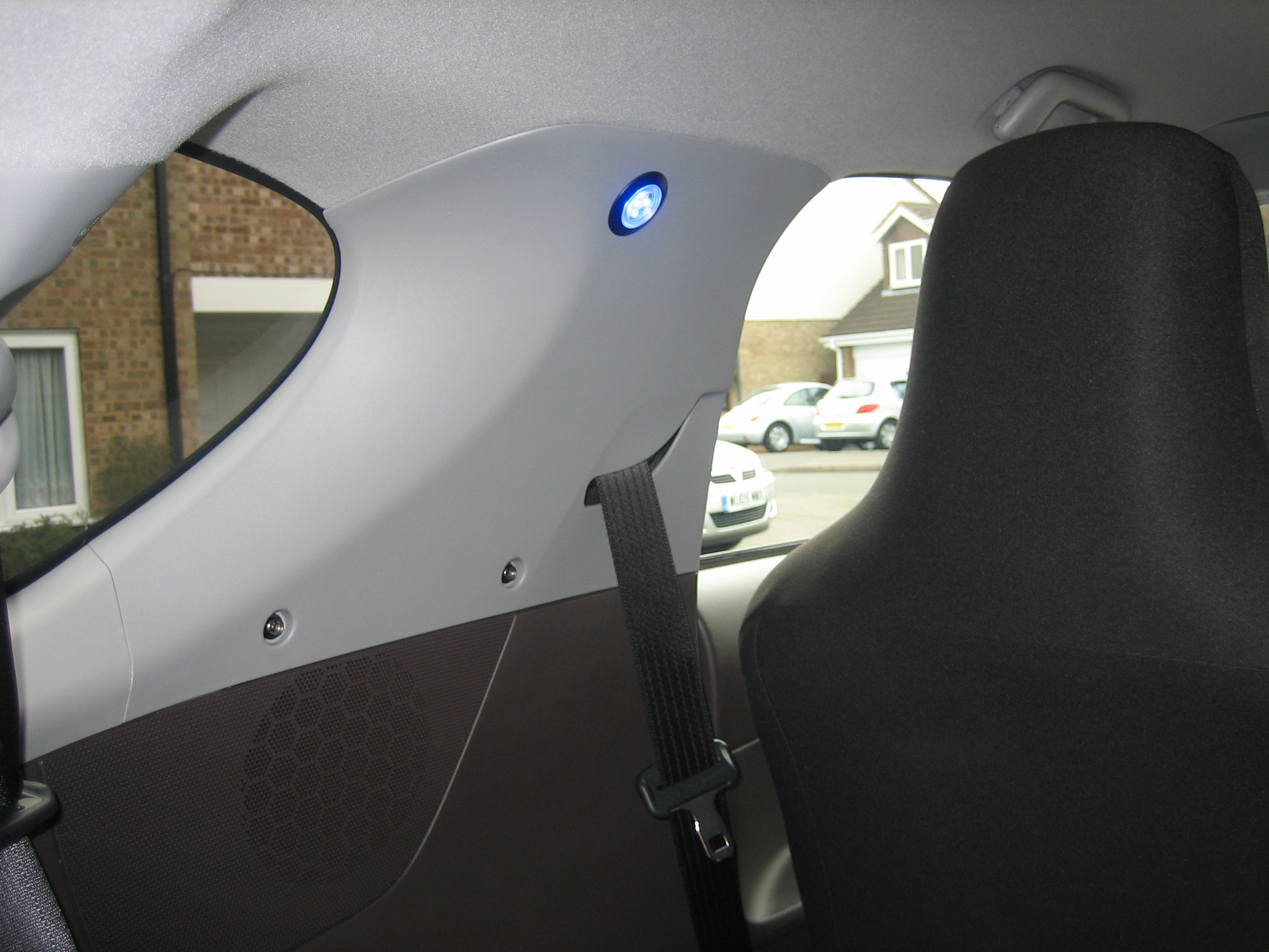

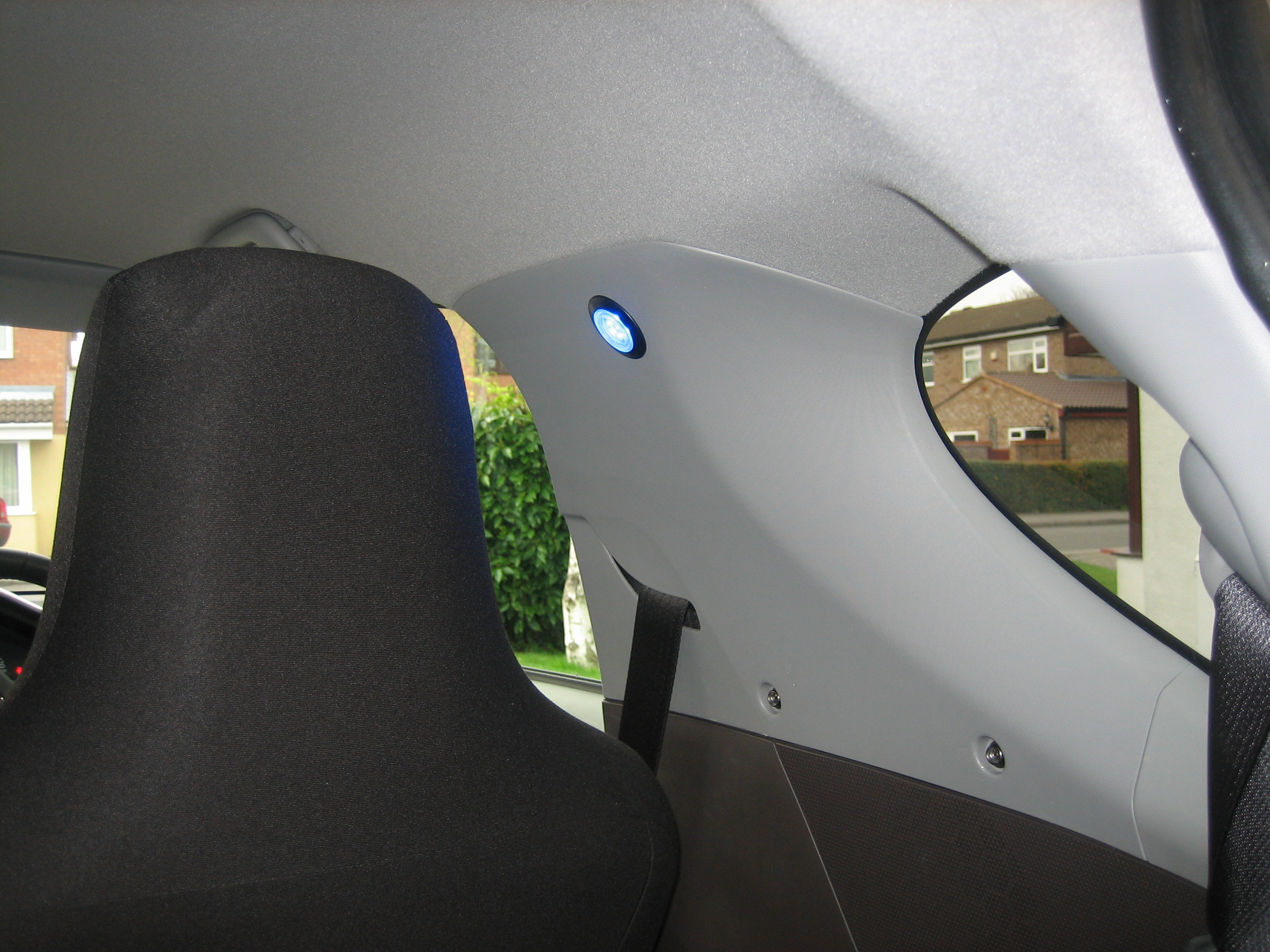

I decided I wanted a more permanent solution to the light in the hatchback problem instead of an AA Battery solution. So I bought a couple of LED lights from Halfords which I have fitted myself ( pictures to follow ). At the moment I just have them wired up to a cigarette lighter plug to see how well they illuminate the back, and they seem pretty good. Ideally, I would like them to come on, and react, in the same way as the pathetic eyeball style interior one, with the same switching options , on always, off always , on when the doors open. It struck me that I could do this by tapping in to the feed to the little eyeball light. But that looks a bit tricky 'cos there's some circuitry in there before the bulb. The feed to the eyeball is 1 black wire, 1 white, 1 black & white. I found I could make my lights come on with the doors by tapping into the black and the black & white. Two problems - if I used this I would have no way of just switching them on, like you can the eyeball ( I would have to open a door ), secondly, running wires up to the eyeball in the headlining is a bit tricky.

The only LED lights I could get from Halfords were blue or red - I went for the cool blue. Looks like fairy grotto. I wired them in as per the 'interior illumination' spec but without the white wire. This means that they come on when the eyeball light comes on, ie when I open any door. I cannot turn them on seperately though.

Hiya, try searching in google for 'Prism LED Single Spot Light Blue ' and you will find them. The picture is not very illustrative - they only show them as in my pictures , that is, mounted in position. In order to mount them I had to drill a ~1 inch hole in the plastic trim. There is a nut which secures them from the back,
