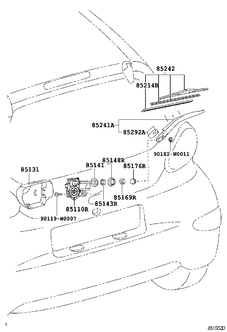

I stripped the boot out, jack, spare wheel, carpet, side mouldings n'all. checked all around for water marks, none. I then set the hose gun on to try to replicate a moderately heavy shower. After giving the back end it bit of water, I looked from the drivers seat to see any drips. Aha... I believe I have found another possible entry for water. The rear wiper motor shaft which goes through the rear windscreen, is not sealed properly, the water gets past the grommet, drips on to the lock clip, and the drips down on to the boot carpet. Depending on the level of the car, the water wets the carpet accordingly. So, I have temporarily used bath sealant around the outer finials to the wiper shaft. Tomorrow, when it's gone off, I'll attempt the hose job again, just to confirm my suspicions. I'll keep you posted. I know, I shall end up having to take the rear wiper out, and refit it with some dum-dum, does any one know how the wiper cover on the inside of the car comes off? I can't see any screws? Is it just a push fit? I don't want to force it and break any clips, like I've done on my other old merc. Any info would be appreciated, thanks. :unsure:
Hi There.
Looks like it is a push fit but not sure how.
Hope this helps.
Ian.
