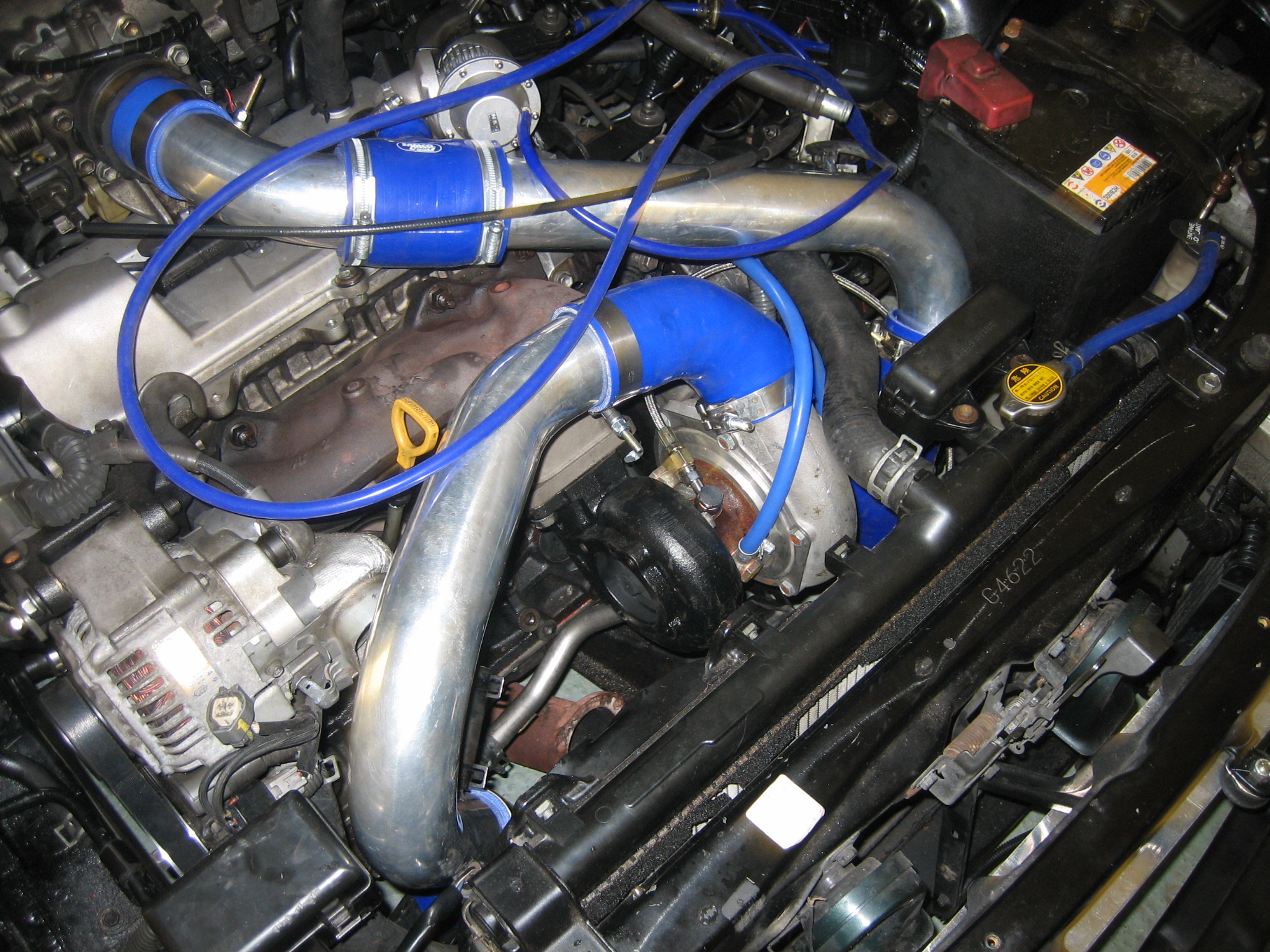

Hi all, just like to say thanks to all who help with the question i had over the last 6months.
here is some pictures.
Spec is as follows:
Wisco pistons
Eagle Rods
acl race bearings all round
Fensport custom made twin place ceramic clutch
Fensport custom made lightend flywheel
arp flywheel bolts
arp main bearing bolts
arp cylinder head bolts
1.5mm steel gasket
sard 800cc injectors
hks dumpvalve
Garrett GT3582r dual ball bearing turbo
tial external wastegate

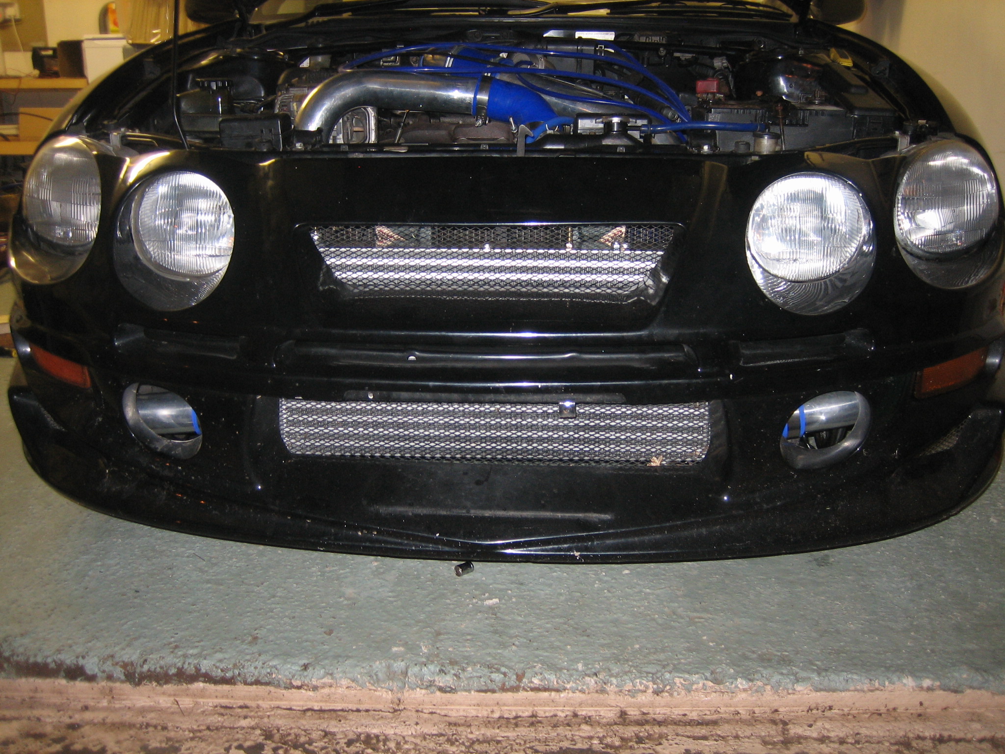

Custom made FMIC
hks evc 5 boost controller
aem afr guage and wideband lamba sensor
hks induction kit
uprated 330mm brake discs
emanage ultimate ecu
uprated thermostate opening at 70c
custom made downpipe
aussie mid section
blitz rear section
crank balanced and lightend
complete gasket overhall
new toyota water pump and oil pump
all engine work completed by engine resource of dundee

looks so good in the engine bay
great job
Wiseco pistons and eagle rods come in a package these days on eBay for not too much, around 400/500 quid check them out on eBay.com. Mahle pistons seem to be the piston of choice these days, i think the escort cosworth had them. Not too gen'd up on them but from what i know they have little heat expansion and i think you can get them in 86.2mm if you dont want to bore your block too much. If i could find the place where to order them from on their website i would think about getting some but its not too user friendly. Not saying wiseco are rubbish or anything i was thinking about getting some myself.
You should relocate your Battery to your boot aj, create more room for yourself.
i think i have spent in excess of £15k on the engine! yeh the pistons and rods cost me £1600, the boy at the machine shop said that they aint normal wisco pistons, they had a special coating on them! yeh the Battery is going in the boot, just waiting on the Battery box and the cable
when you get that running you should post some videos.
im sure it will sound amazing.

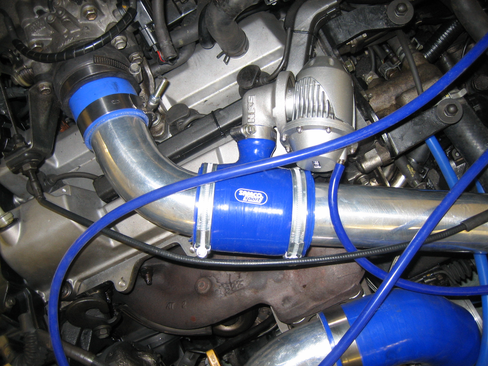

can i ask why you went dumpvalve as to blowoff?
it aint finished yet. next two weeks i think, still to be mapped. a blow off valve and and a dump valve are the same thing aint they? there is a difference between a wastegate and a blowoff/dump valve
Yeah pretty much the same thing, dump valves just do not let continuous air into the engine. When the throttle closes, the dump valve lets off the pressure. This is because the pressure on the backside of the turbo is at a higher pressure than on the front side. A blow off valve equalizes pressure on both sides of the turbo.

would defo be worth gettin the rev 3 MR2 throttle body part as i found that sleaving it inside the original rubber causes it to blow out after a while.
you need 2 parts and the bottom longer bolts but it works so much better. gives a better location for a water injection jet too.throttlebody.jpg
i lined the rubber with a bit of metal tubing allowing the clamp to grip on somthing more substantial. but quite interested in the water jets tho
yeah i did the same and it still blew out a few times.
water injection is a very good safety feature, id look at the ERL kits though others are availiable and a bit cheaper but the ERL kit is by far the best for being compact and reliable
will the emanage ultimate be able to run this or will it have to be independent with a button in the cabin?
