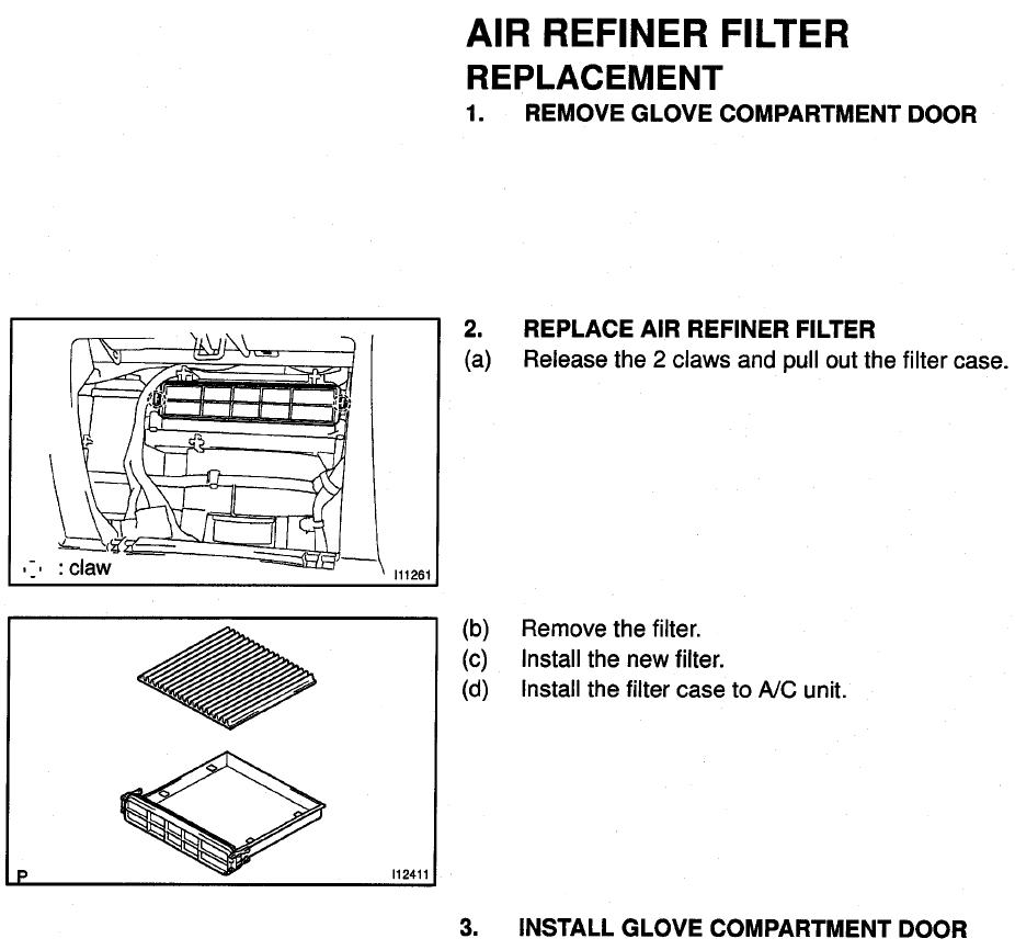

It is behind the glove box door. Simple to change just pull it out and replace.
See the service manual sticky at the top of the main Yaris forum page. Would recommend downloading it. Has guides for everything.
It seems that only Yaris's with air conditioning have pollen filters. Mine has just got a blower so when I pulled out the glove compartment and had a look, nothing was there.
All models of yaris have pollen filters as standard, it can be hard to spot but if you look right to the very top of the motor you will see a rectangular panel with lugs at either end of it, just give these a gentle tug and out it pops.

The genuine Toyota ones are £10. Ordered one from Parts-King.
See picture attached on how to replace.

Most don't have filters as standard but most have the empty container. It takes a very short time to fit a filter but be careful you don't break the glovebox.

All models of Yaris sold in the UK from 1999 (S to CDX) have pollen filters as standard, if you come across a filter panel without one then it has been removed ( probably to improve ventilation when the filter gets blocked with debris and not replaced)
A quick check to see if you have one fitted without removing the glovebox is to set the blower on full power and the vent set for fresh air and head/face height, if it spits out bits of leaves or debris then chances are it has been removed.
