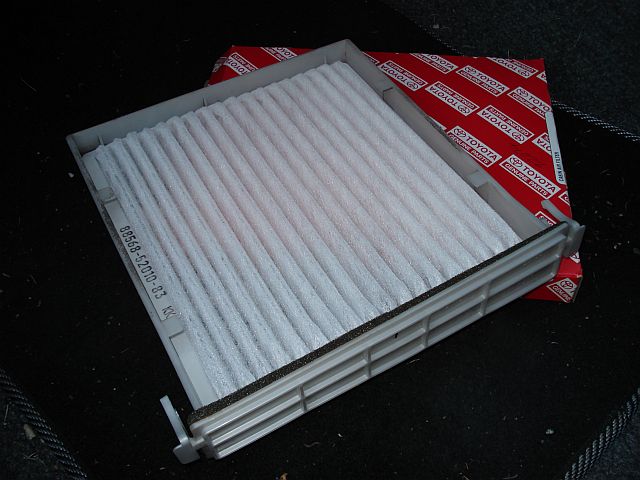

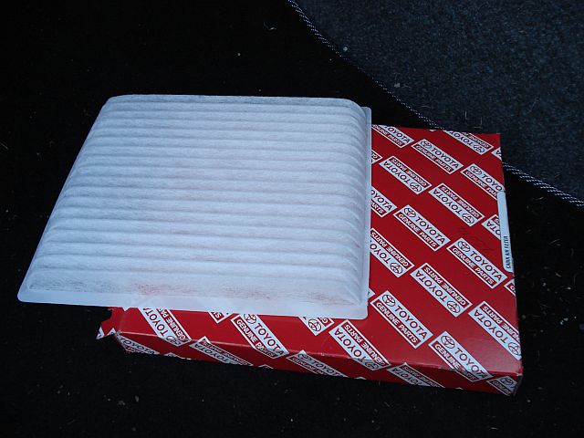

Had a drive to the Toyota dealers today and bought a new one, £12.73 with the VAT.

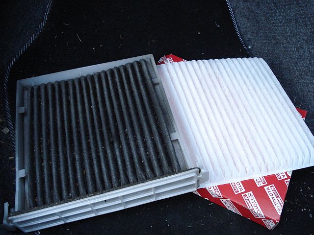

Now i changed the cabin filter in that about 3months ago and i was amazed to see how filthy it was, and just how good the heaters and air-con are in that now! :D

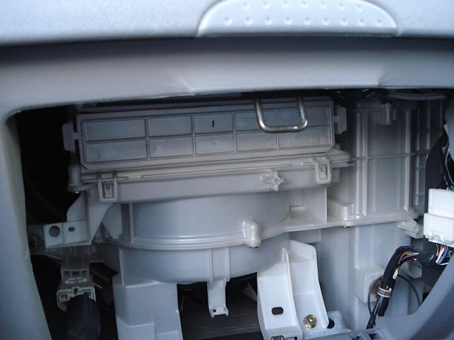

Remove the glove box by opening it then pushing the sides in whilst pulling it down carefully.
Then you see the filter holder behind the glove box (when box is removed)
Grab hold of the lugs on each side of the holder and pull.
Out it slides and look at that filter!!
If it's as dirty as mine was you will be amazed! (don't think mine has ever been changed in my car)
New filter in it's holder, slide back in till it clicks

Got my new filter from eBay. Gen Toyota one, similar cash including post. Make sure the dealer has one first as it may be a wasted trip!
