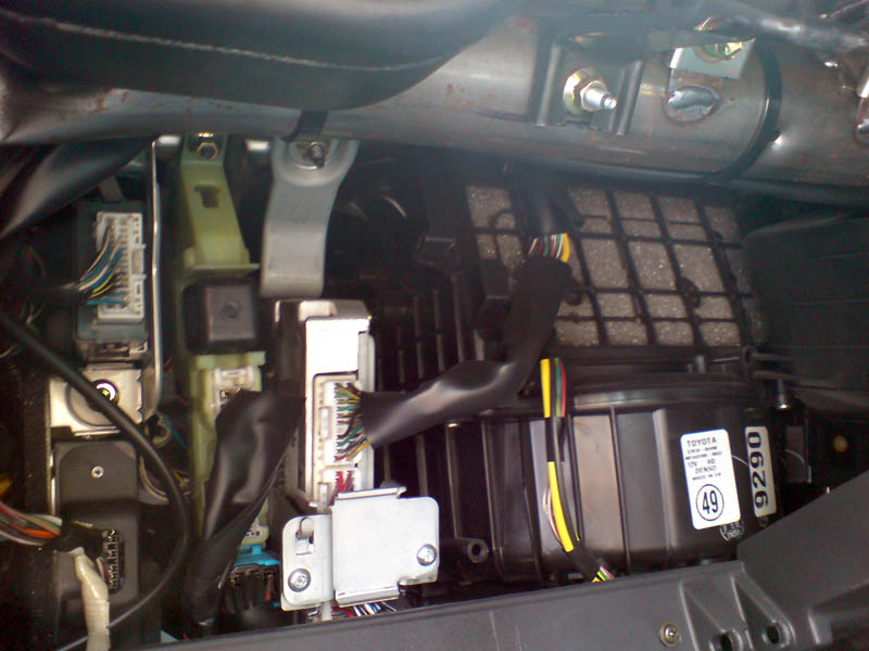

First of all thanks to everyone so far!
I managed to the get the glove box out. No hassle really but...now where is the pollen filter? and how do I get it out? Please check the attached photo (picture quality is not great...).

Isn't the pollen filter the grey foamy bit middle right on your picture?
Here it goes. I took her to Mr T for Re-gas AND replacing the pollenfilter. Airflow improved andthe A/C is now cooler.
I must have been a combination of things.
Thanks for all the hints and the advice.
