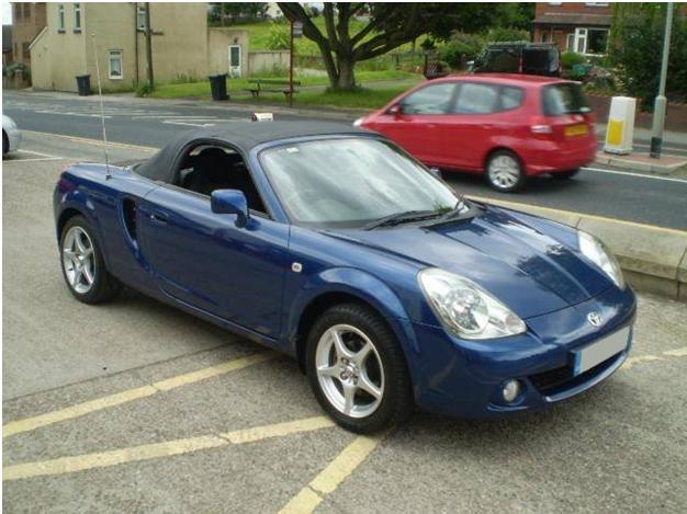

I just purchased the car I mentioned at the top of this thread... is has a full service history except for one intermediate service... had the full 60,000 mile service after that tho...
I test drove it and it sounds perfect, and seem as it's a facelift it's got loads of cool little extras... but no hard top.
Anyway i'm very pleased with the car and can't wait to pick it up next week.
Uploaded a picture of it bellow:
Nice looking car there man ;)

That's the same as my baby :D
Thanks, I get it Tuesday or Wednesday... cant wait.
