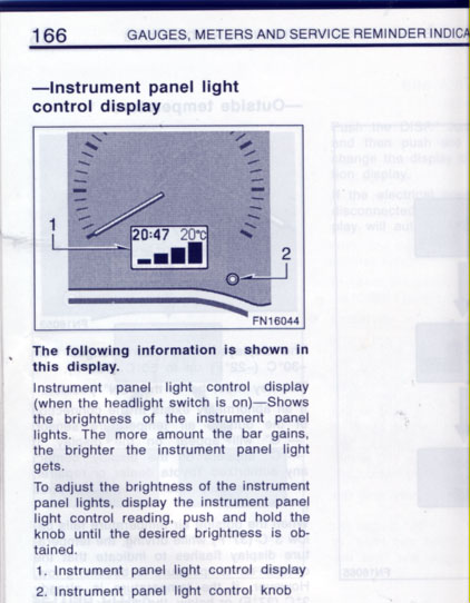

Any help see attached
Thanks for the reply mate but for whatever reason that did'nt work my avensis is an 04 t3x maybe they changed it,
when i turn my lights on the dials dim but the annoying thing is in the day when they are really bright it glares thanks ,again mate.
Hi,
When you press the trip button, it cycles through total miles, trip one then trip two. You need the headlights on to access the bar icons to alter the dial brightness. Turn the headlights on, press the trip button and after trip B, it should come up with the icons, keep the button pressed and the lights should cycle light to dark.
Les
sorry i forgot to tell you to have the lights on when switching between trip a trip b
