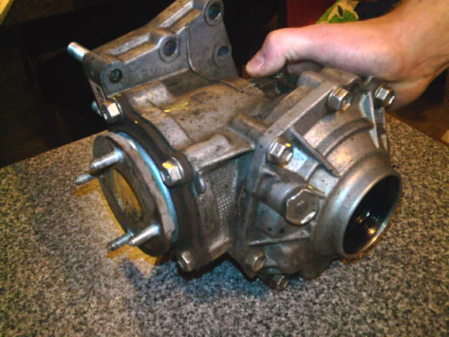

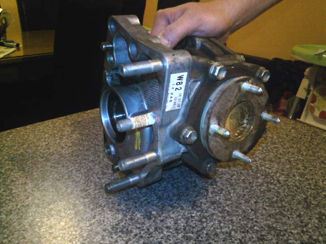

Hi All
Ok, So the transfer box has arrived and the other half is humming and hawing and saying it's not gonna fit, and of course i'm the bad one cos i ordered it and organised the shipping on it! :ffs:
I have taken a couple of pics of it, can ANYONE tell me if this is gonna fit in a 2002 Rav4, 2.0L turbo diesel???
Thanks so much.....
P x
I myself can`t see there being a difference, between the petrol and the diesel. But there`s only one way to find out.
