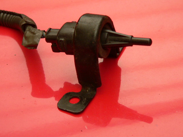

Attached to the rear bulkhead (just above the turbo!) is a device that looks like an air temp sensor (hopefully see pic attached).
What is this ? and Where is it mounted on a standard MR2T?
Any info would be appreciated.

That sensor is mounted on the engine lid on the MR2 Turbo (would be about the turbo area - up by the pre-intercooler hard pipes). It is then linked to a chunky fan on the intercooler.
It is a VERY common mod to disconnect it. This makes the fan run all the time.
Are you sure this is the issue?
Thanks for that Bibbs.
I tried disconnecting the sensor - and the fan still doesn't run! I plan to hardwire the fan to a switch on the dash and also fit an auxiliary fan to blow air across the engine bay.
I am reasonably certain that the problem is related to under bonnet temps, as it was ok with the rear clip removed.
