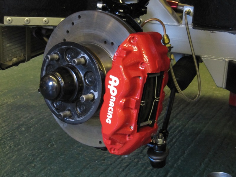

My DAX brakes are painted with red agricultural, Massey Ferguson red. Stays on just fine with an etch primer on the zinc plated callipers first.
