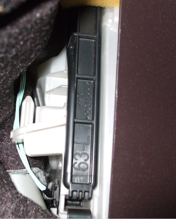

I just nipped out and took this picture which is taken from inside the footwell looking behind the edge of the plum panel towards the driver's side.
The release tab I mentioned is the lowest black part of the vertical thing, that is nearly cut off in the picture.
