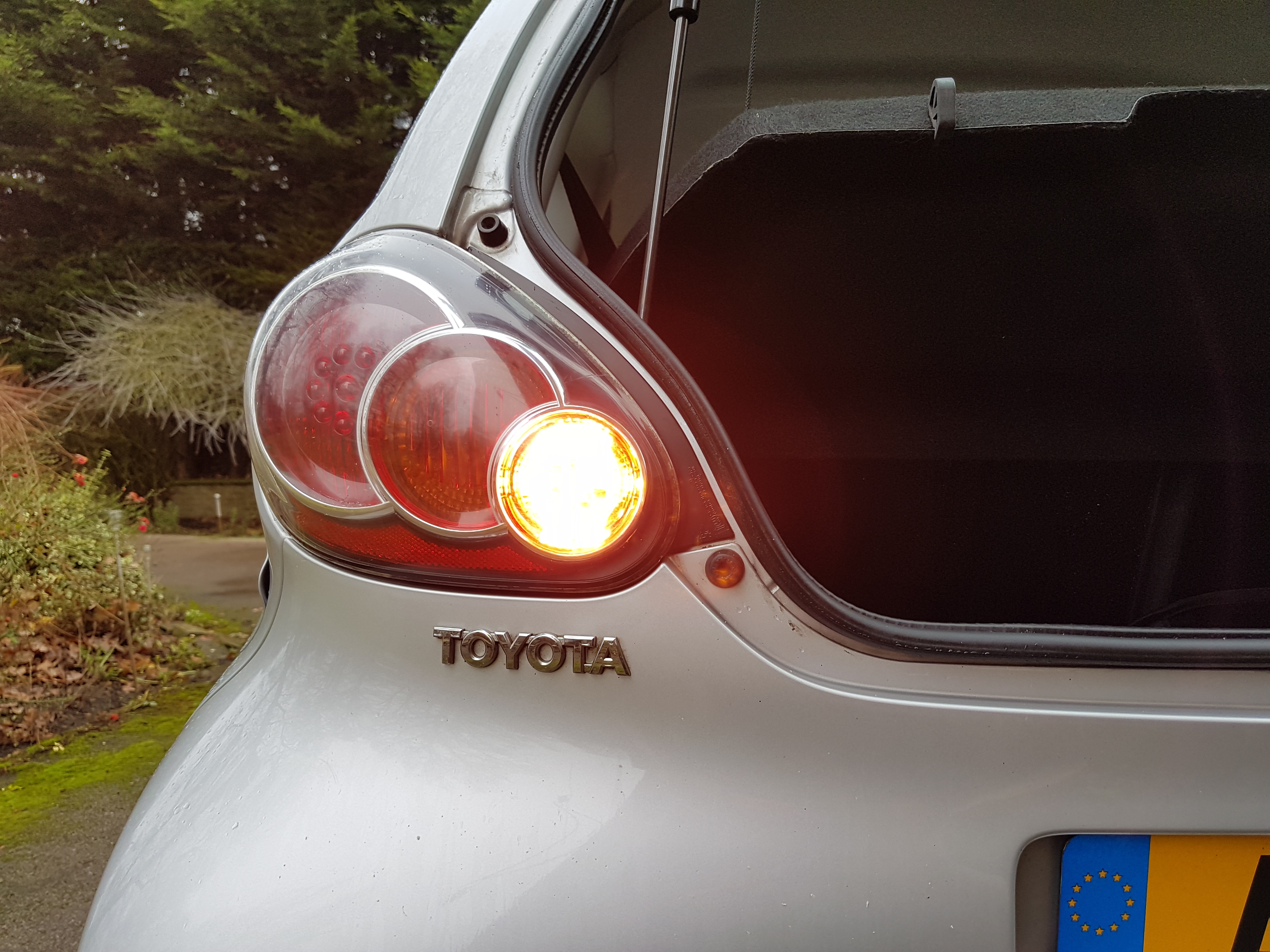

I fitted the 50W bulb from the link in my previous post and it works fine.
At least no fires yet :smile:

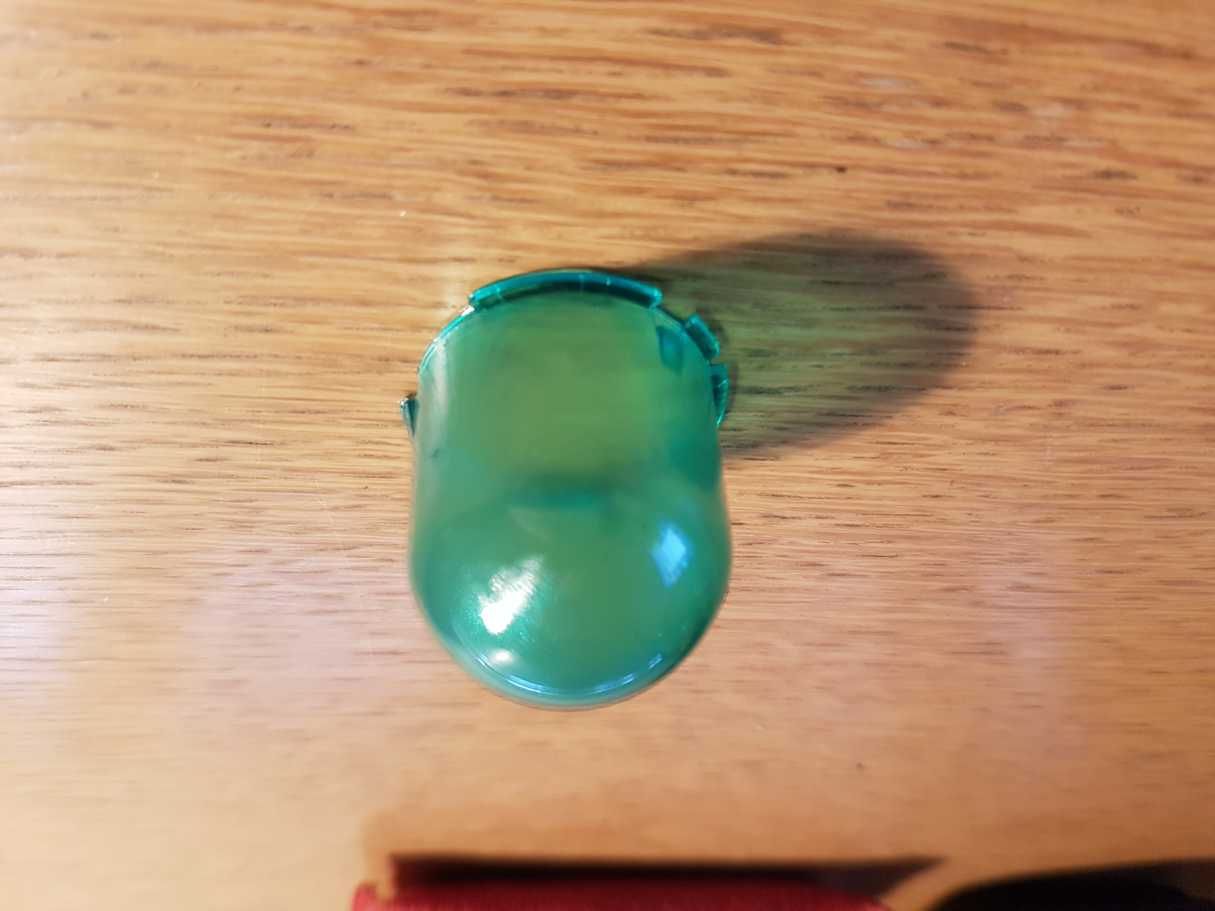

removed mine today in advance of fitting the new lamp, found the inner lamp shroud on the brake / tail had shattered so that's repaired and refitted but ......
Found that green tit thing sat inside the reverse cluster and that's because the outer plastic is tinted 'pinkish', the green thing reverts the light to white but at the loss of quite a lot of output as it's an opaqueish green filter.
So i've removed it and it really isn't that noticeably 'unwhite' without it. I'll see how much less strangled the output is tonight without it fitted. FWIW i think the 50W halogen could melt that over time and you'd not know because it would be inside the light itself.
If this isn't enough, i'll be quite happy to fit the 50W halogen reverse lamp now that the green thing is removed.
Right. You NEED that green tit in place as it's also a diffuser and without it, you get a really weird beam spread. So i'll refit it, fit the halogen lamp  and check it on it every few weeks to see how it's doing.
http://www.ebay.co.uk/itm/301864217475
Ordered one of those as well - will try both but the LED is preferred as there's less heat ouput.
Tried the Halogen - the LED in the link above has it licked both in brightness and in power requirements. Both fit without issue.
