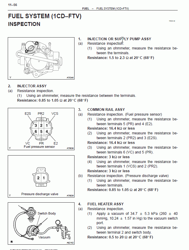

Hello,
here is how to test the scv, just click on the drawing to make it easier to read :-).
Regards Pete.
post-74463-0-39144700-1369294294_thumb.g
