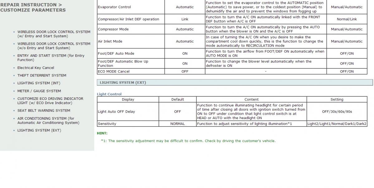

I believe there is an option in the car software for the lights to stay on for a period after you stop and get out or the "guide me home" lights as you say.
I'm sure it's there, just not normally switched on in the UK cars.
Craig.
Here we are, under the customize parameters. These should be available with the computer system at the dealer. providing they have all the correct software for the iQ.
Default is off.
Craig.
Default is off.
Craig.
Hmm, must have missed that when I read the manual, and yes I did read it :)
Don't think it's in the manual but it's in the workshop manual CD that I very luckily got to see. :)
Shame I don't have the software as I could have fun playing with the parameters. :)
Craig.
