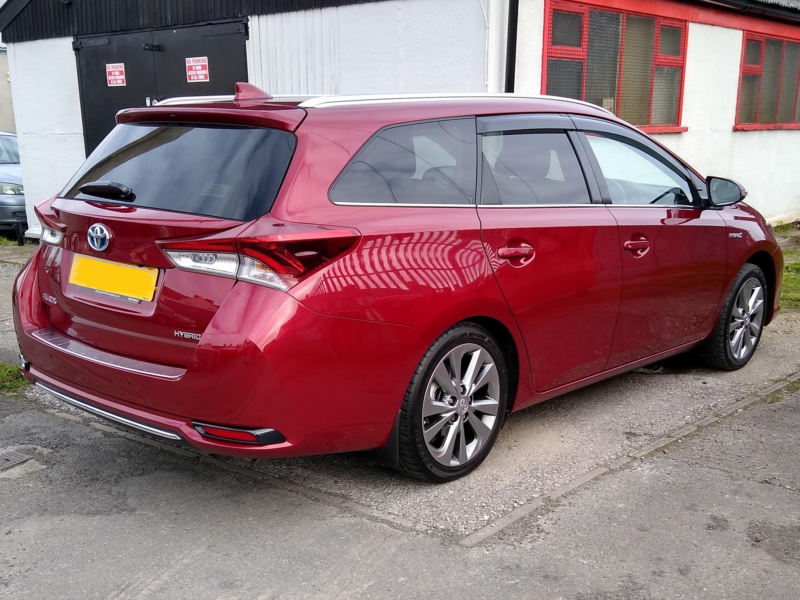

I fitted a full set 3 years a full set to the Prius three years ago. I trawled through eBay and found some for around £50-£60, checked reviews and eventually bought, not from eBay, but direct with Climair in Kent for just shy of £100. They fitted easily, no extra wind noise, Windows go up perfectly, look good.
Re fitting. In the Climair instructions it specifically said after fitting, test the window goes all way up and down a few times, then leave the window up for a day. There is a sticky fixture, so by closing the window until next day means the closed window is holding the Climair in place whilst the sticky sets. I have had no problems.

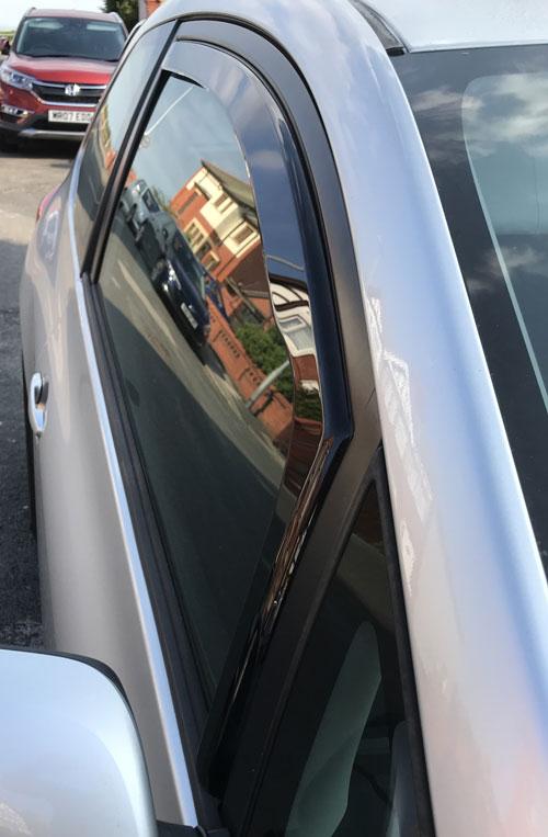

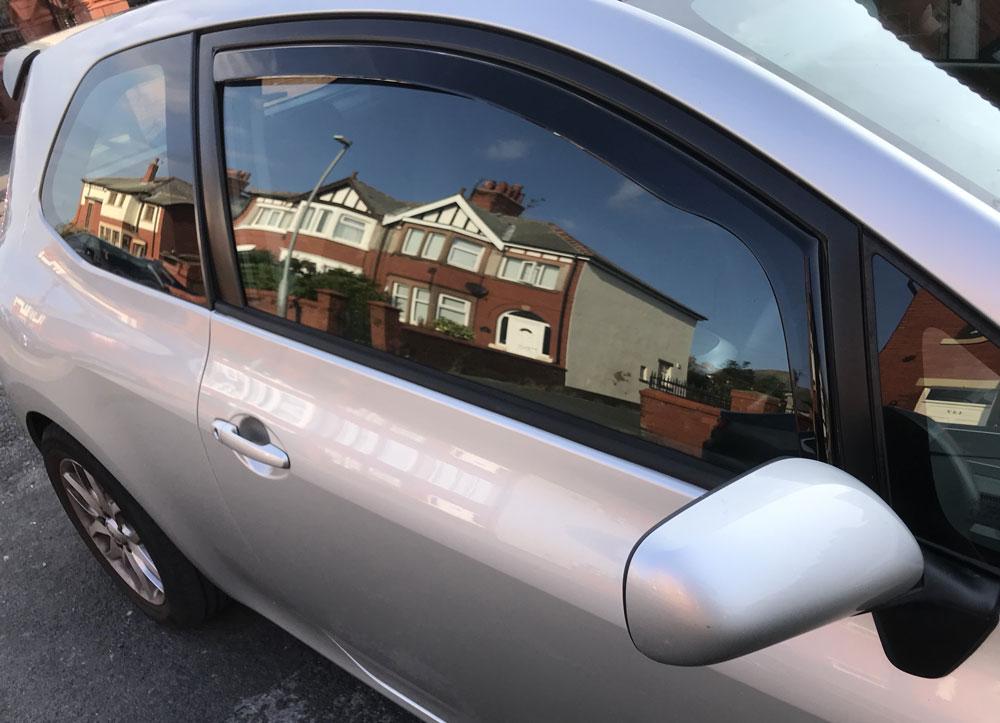

Got round to fitting them last night. Very straightforward, only hitch was on the drivers side when I tried the electric window it bounced back down, a quick wiggle and the deflector was seated properly and window works fine. Much better driving with the windows down now and water not dripping onto tweeters!
It bugged me how everywhere sold the TWO piece three door Heko sets sets for MORE than the 5 door sets that had FOUR pieces! 😄 I guess there are less 3 door Auris or something.
